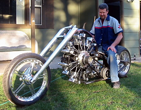

PostPosted: Wed Dec 02, 2009 10:34 am    Post subject: Changing type of oil Reply with quote
The attached is a beautiful radial engine car...
George Coy
CAS Ltd.

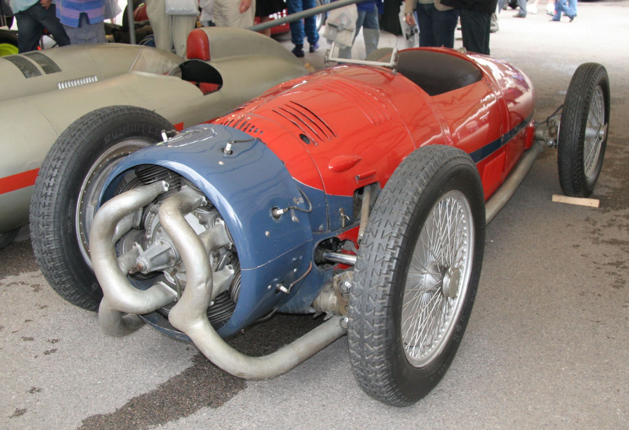

eddiemoranii(at)yahoo.com
PostPosted: Wed Dec 02, 2009 11:13 am    Post subject: Changing type of oil Reply with quote
And this....

jan.mevis(at)informavia.b
PostPosted: Wed Dec 02, 2009 11:55 am    Post subject: Changing type of oil Reply with quote
And it's an eight cylinder? Or am I mistaking ? Might need other glasses ...

george(at)gesoco.com
PostPosted: Wed Dec 02, 2009 12:02 pm    Post subject: Changing type of oil Reply with quote
Ah Ha you are correct and it has an even number of cylinder because ..... It
is a 2 cycle engine!

There was also another radial engine powered car
design: The Volkswagen Beetle`s early prototypes
had a 5 cyl. 1200cc radial engine in the rear.
This VW- and the Monaco-Trossi racer`s engines were
not aero engines.
If anyone could find another car with radial aero engine,
please let me know...
Yours, Uwe Wulf
