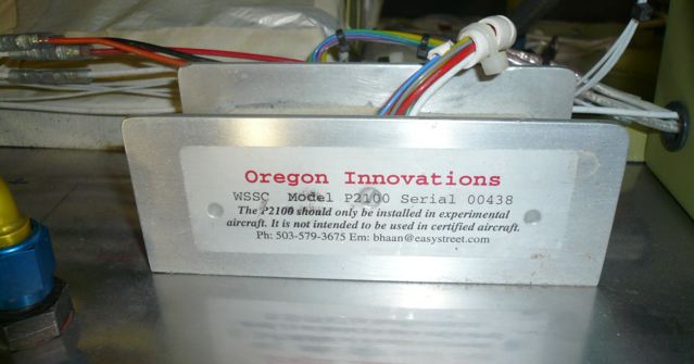

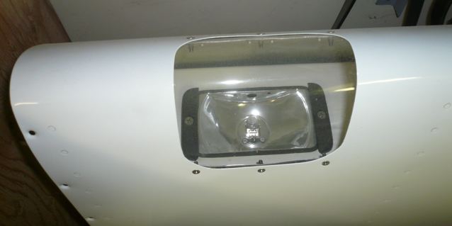

Hey everybody, late last century, I bought a wig wag unit from a company called Oregon Innovations. The phone number on the casing doesn't work but the Yeller Pages has 503-720-1132 for Bob Haan. That number does work but no answer today.
I am wondering if this flasher unit will work with new HID's from Duckworks. Do many people have this flasher?

Mine just stopped working. Tried in vain to contact the maker to no avail. Probably no longer in business. They’re not repairable either. Instead contact http://www.maxpulsemaxdim.com/ and get something ten times smaller and with more features plus way easier installation for $200! I just installed it and did completely away with three light switches and some now extra wires. Way cool!
