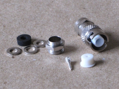

I need to do a little more research but the original question was about
the coax from the KI-214 to the glideslope antenna not the connection to
the KX 170B. He thought that the KX 170 B manual would have the info he
needed. He hasn't seen this type of connector before and didn't know
how to connect it to the coax.
I've found a picture of the thing . . .
[img]cid:.0[/img]
I vaguely remember seeing these on some installed equipment.
I think these are a Kings Connectors KM59-13. I don't
recall seeing these very often in the coax cable version
but they're popular now for a bunch of fiber-optic
cables.
I've not yet chased down the installation specifics
but I'll bet they're VERY close to the venerable
solder-n-clampnut versions of the BNC connector.
http://www.amphenolrf.com/pdf/299.pdf
Perhaps someone on the List can enlighten us
further. I'll keep looking.

That same connector is on the back of a King KI-214 VOR/LOC/Glideslope indicator. In that application it carries the 350 MHz Glideslope signal from the antenna (or diplexer), since the receiver is located in the indicator.
