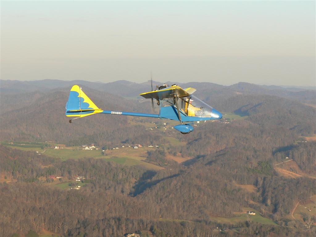

Vince has already mentioned this, here's what it looks like - (the farmer who leases the field the airstrip sits in was baling hay that day)
N582EF will fly hands off, you can herd it around quite well with rudder only.
Richard Pike

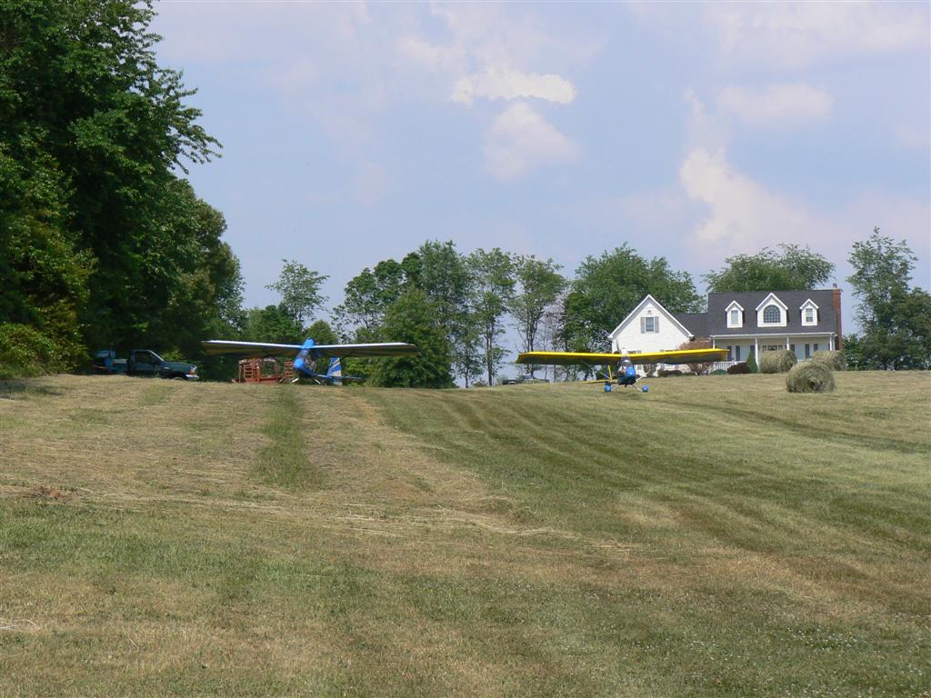

Here's another view of the FSII that shows the dihedral -
Richard Pike

Change of subject triggered by your great photo of the FSII in profile.
Did you happen to document any changes in airspeed or power requirements with and without the wheel pants?
Most Kolbs fly without them but I'm considering downsizing my Slingshot 800x6 tires to 600x6 and installing wheel pants. I plan to do that and document the effects of reducing tire size and then adding the wheel pants. Since it is stored for the winter, I won't know the results until next spring. For what it is worth, with the big tires my top level speed is 95 mph TAS and I normally cruise at 80 mph at about 72% power when going somewhere and about 65-70 mph and 50-55% power, otherwise. I'm hoping to get another 3 mph at cruise with smaller tires and hopefully another 3 mph with wheel pants.
When I slipped a piece of streamline strut fairing plastic over each landing gear leg of the MKIII, that made a difference, it noticeably changed the trim. Once I had eliminated a source of drag down low, the airplane wanted to nose up. Did not do any before and after, with/without tests, but the difference was very obvious.
Several years ago, changed the original cable brakes to real hydraulic brakes, and had to lose the wheel pants, couldn't figure out a way to make a decent bracket. Did not notice or document any before/after cruise or top end speeds, but didn't notice anything. Using 15X600X6 tires. Removing the wheel pants did not seem to change the trim at all, for what it's worth.
My point is, if it makes a difference in drag that far away from the airplanes center of drag, you ought to notice it in nose up/nose down trim.
I have made a bunch of little streamline mods to the MKIII, and am not sure how much they add up, but it makes sense that it ought to help.
