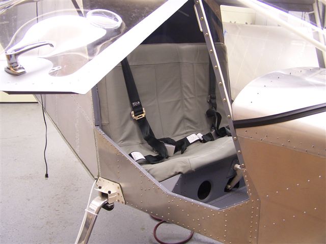

BTW, here is a picture of my DIY upholstery seats I just completed. Got the foam kit from Hi-Tech Foams (http://www.seatfoam.com/). Bought a hide from Midwest Fabrics (http://www.midwestfabrics.com/) for $100. I made the backing from ¼” think end grain balsa sheets covered in fiberglass. I put a few carriage bolts through the back to hold the seat with wing nuts. Sewed the seat with my wife’s machine. It was a lot of work but I think it turned out okay.
Curt
