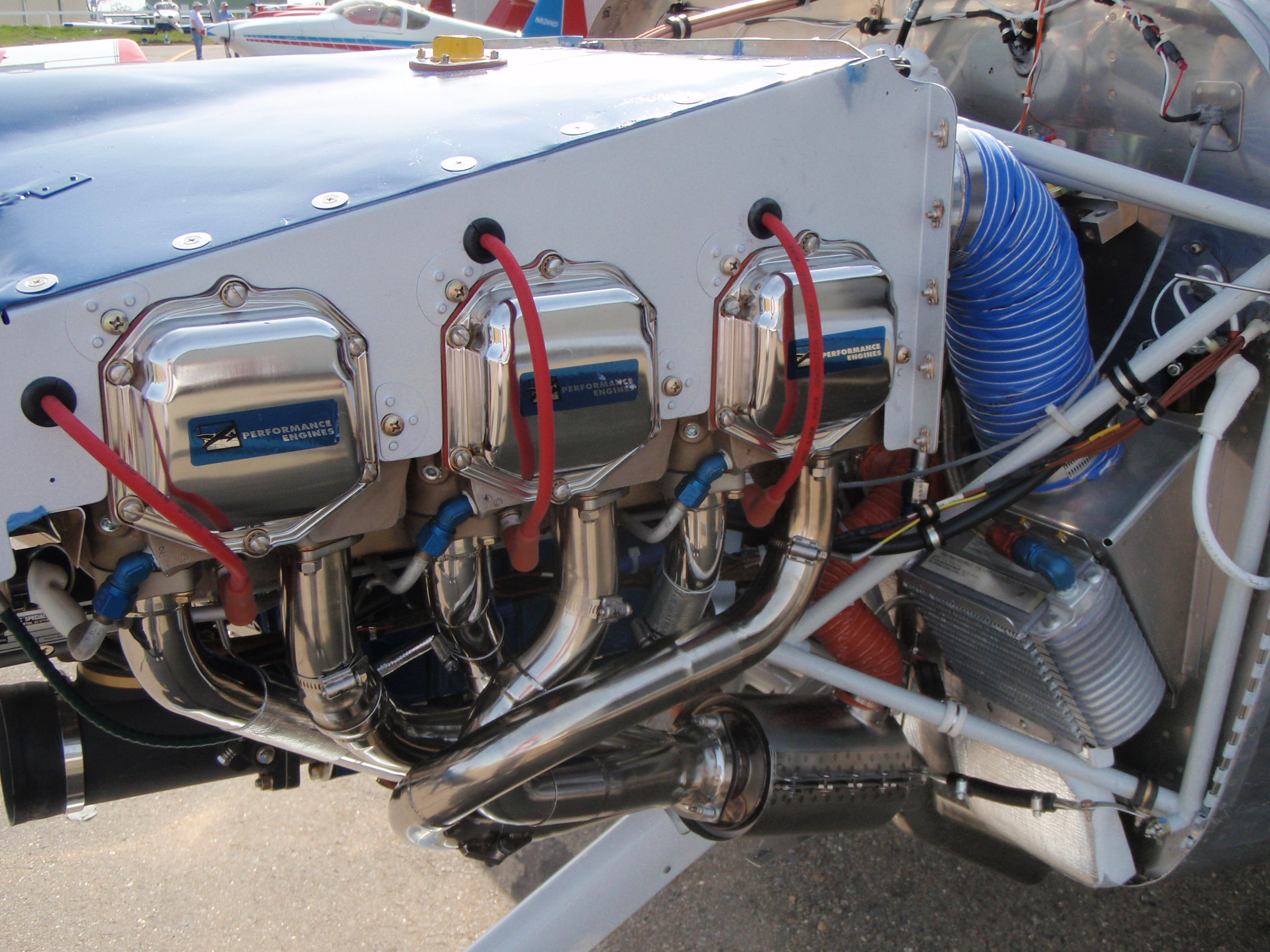

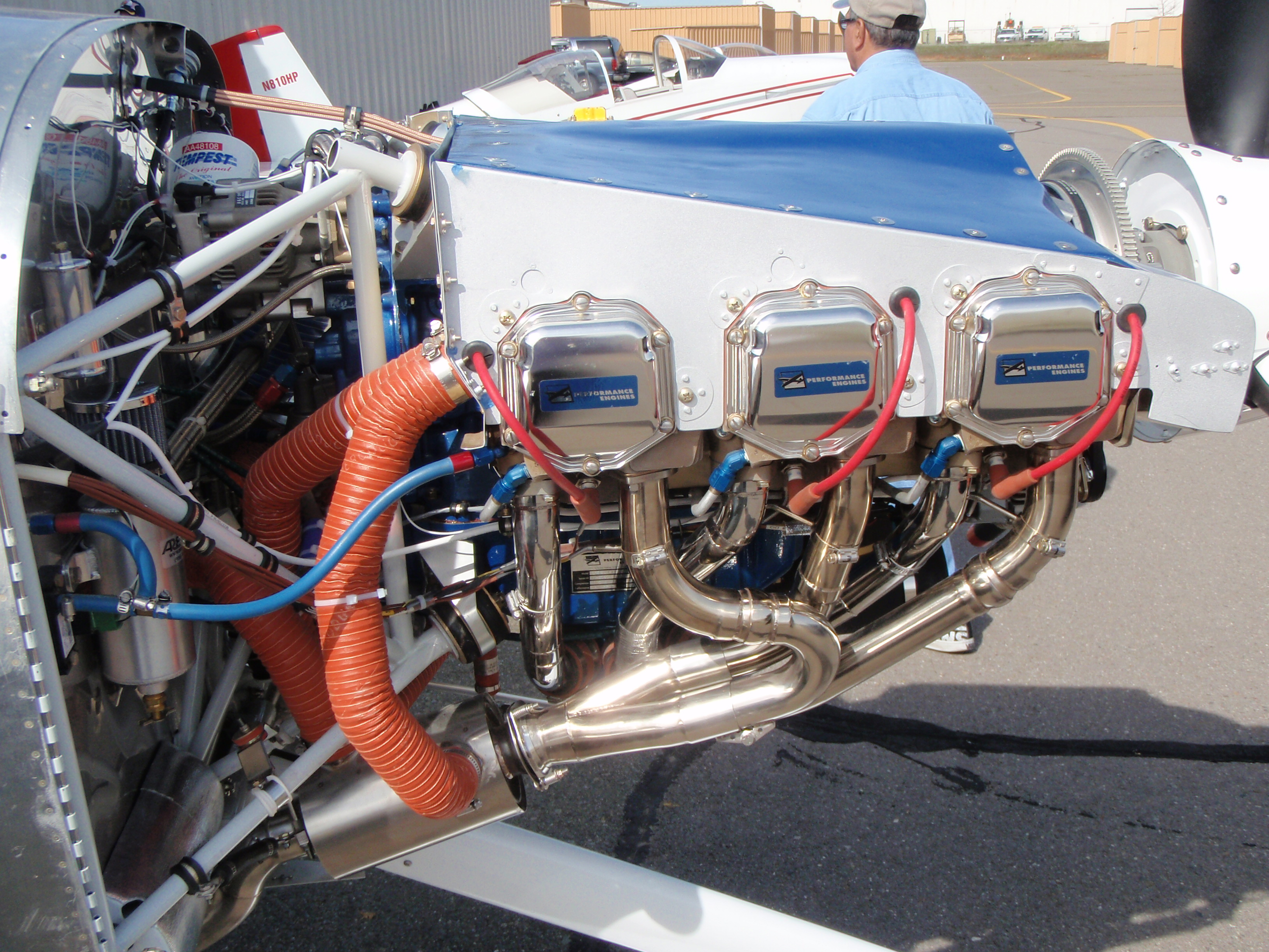

PostPosted: Sat Nov 21, 2009 5:22 pm    Post subject: side baffles side Reply with quote
Jesse, because I built a plenum, I also built the side panels so I could simply screw/bolt the plenim directly to the top of the side baffles.  It's all on cadcam and we just run it out to the shop where it gets punched out just like Van's does... then over to the brake to put a 90 degree 3/4" lip on the top.... so it's already setup.... I'm going to make Pascal a set, and he/we were just trying to find out if there were any additional issues.
Linn, as to your statement about them ending up in 3 pieces anyway.... I use a floating system whereas the screws tighten down on stainless shims, thicker than the baffles, thereby letting the aluminum baffle float. So far 90 hours, no issues.
Thanks guys, Don

Jesse C because I built a plenum C I also built the side panels so I could simply screw/bolt the plenim directly to the top of the side baffles.  It's all on cadcam and we just run it out to the shop where it gets punched out just like Van's does... then over to the brake to put a 90 degree 3/4" lip on the top....  so it's already setup.... I'm going to make Pascal a set C and he/we were just trying to find out if there were any additional issues.
Linn C as to your statement about them ending up in 3 pieces anyway... I use a floating system whereas the screws tighten down on stainless shims C thicker than the baffles C thereby letting the aluminum baffle float.  So far 90 hours C no issues.
Thanks guys C Don
Thanks guys, Don

Well, I was hoping to avoid admitting that I 'had a better idea' when I
rebuilt my baffles on my Pitts. I didn't want to rivet the plates that
capture the adjacent part .... so did it in one piece. I bolted the
single part on .... and about 1 year on the new part .... it started to
crack. Stop-drilled the crack didn't keep it from migrating. Over
about 4 years .... I had 6 pieces .... with the capture plates riveted
on. When I got cracking from the mounting holes I rebuilt with 3 pieces.
Maybe having them float would have prevented the cracking.
Linn
Thanks guys, Don
