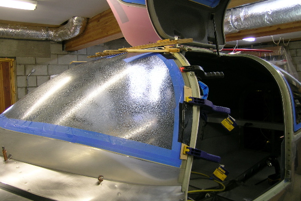

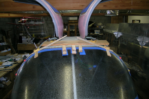

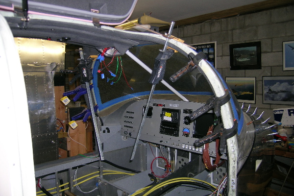

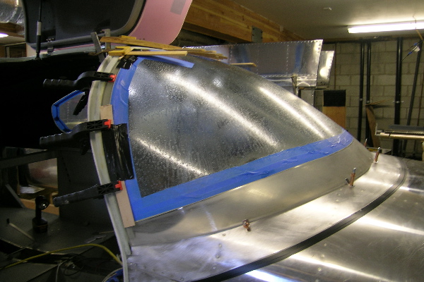

Thought i would post a few pict on how I glued in my windscreen. I had heard about all the craze line issues and I even went as far as to purchase five tubes of Sikaflex for the side windows. I never used the sikaflex so if anyone want to purchase the five tubes for a quarter of what it cost me C let me know.
The key to clamping the windscreen IMO in is distribution of pressure. I used several laminations of 1/16" ply C aircraft modeling plywood to distribute the force. The pictures should tell the story. Also C I used wooden wedges to push down on the plexi where needed. Note the 3/4" ply used across the top of the canopy C clamped to the canopy C but it is the wedges which are pushing down on the plexi. This entire process is a two person process and it needs to be rehearsed. One person should spread the Weld On on the canopy rim while the other is doing the windscreen edge. Pressure to the windscreen should be applied at the top and then incrementally going out to the sides C each side at the same time. Tape should be placed on the inside of the windcreen and outside with the inside tape removed once the window is clamped. Get all the hairs of WeldOn off the plexi immediately.

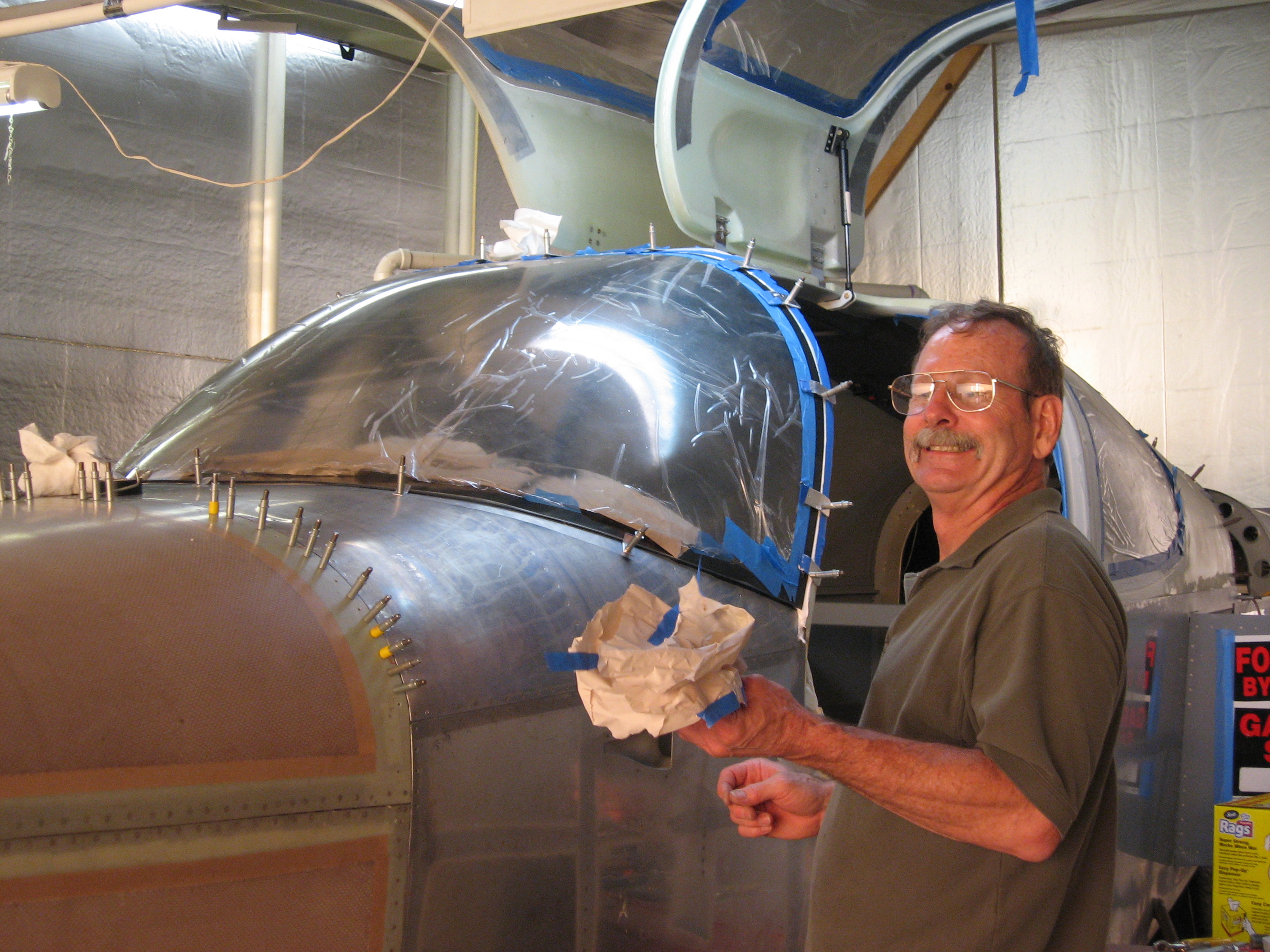

I had to replace a windshield that was broken when a Columbia crashed into it. It was already actually broken, so it couldn't be removed in one piece anyway. I used a rubber mallet fairly gently to break the pieces loose from the glue (not weld-on) and then used a die grinder to remove the glue. For a whole window, I don't know what I would recommend, but probably a router or heat like others have mentioned would work well.
When installing, we put a piece of cardboard over the window and tie a rope from one spar center section over to the other to hold the lower part of the windshield in place and then drill some #40 holes and use little pieces of flat aluminum and clecos around the rest of the window. We've never had a crack. Attached is a picture with some of the clecos in place, but not the rope.

we used the "fingers" on all windows. .An even gentle pressure is exerted all round. Check with Mike Andresan on Friday. I showed him the technique on his left rear window and he has used it on others. Or you can call me on 480-626-4048.

I too just replaced my front window. Used a router and then cleand up as needed. I talked to weldon tech and they said if you do not get it all off (weldon) you should still get the same bond as before. I too used fingers but my problem did not occure from that, it was through out the window. Gues what Van had to say. Never seen or heard of that before. Try micro mesh. No thanks
Here's a couple of pic of my install and what it looked like.

Do Van's has selective amnesia then because I sent them a similar picture 2 years ago.....
