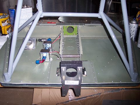

I painted one last year with just etching primer that Auto Zone carries in a rattle can and it still looks just like it did the day I painted it. I used to use 2 part etching primer but the Green etching primer at Auto Zone is all I use when building and it dries super fast.
Jeff
