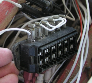

So your quest for an ASSEMBLY of independent
fuses to be wired into a variety of wires
needing protection doesn't make sense. The
style of fuse holder you're asking about DOES
exist in a number of products:
[img]cid:7.1.0.9.0.20091206191629.01d4cf88(at)aeroelectric.com.0[/img]
This photo is for one such device. But it's
utility is LIMITED to a few instances where
RISK ENERGY SOURCES for all wires to be
protected is located close by.

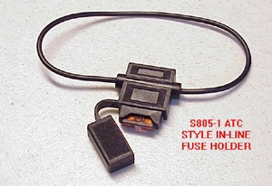

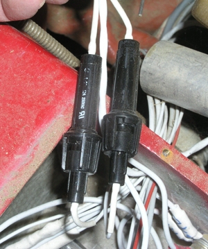

For the instances in the Z-figures where
single lines are fused, in-line fuse holders
are recommended. Avoid any style that uses
cartridge fuses:
[img]cid:7.1.0.9.0.20091206191629.01d4cf88(at)aeroelectric.com.1[/img]
Holders for blade terminal fuses are preferred
for longest service life:
[img]cid:7.1.0.9.0.20091206191629.01d4cf88(at)aeroelectric.com.2[/img]
Splice these into the protected wire as close
as practical to the risk energy source.
