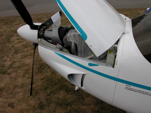

fklein(at)orcasonline.com
PostPosted: Wed Nov 18, 2009 7:57 am    Post subject: Cowling with no access doors Reply with quote
On Nov 18, 2009, at 3:42 AM, Raimo Toivio wrote:
And much more easier and fun if the cowling is easily removable. I
have one friend who hasa plane with cowling with hinges and gas
pumps to keep it open.
Alex Bowman hinges his top cowl...wouldn't have it any other way...
Fred

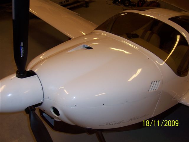

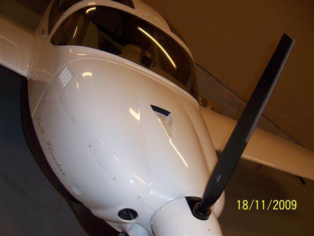

PostPosted: Wed Nov 18, 2009 11:16 am    Post subject: Cowling with no access doors Reply with quote
Fred,
that is beautiful! And cannot see any access doors...look at mine also, attached a pair of pics:
She also with her easily removable access doorless cowling is cute like a virgin, isnīt she? ; ~~ ))

frans(at)paardnatuurlijk.
PostPosted: Wed Nov 18, 2009 3:20 pm    Post subject: Cowling with no access doors Reply with quote
Raimo Toivio wrote:
A good pilot follow (his) rules always - also when hurry and a storm is coming.
If he has not time enough - he will cancel the planned flight.
A bad pilot does not and the easily openable access doors do not help.
She /he will skipp also them. That is so simple.
Ok, you are right.
Well, I should have started this topic earlier. I now have these silly
access doors, and should have invested the time to make them instead in
making the entire cowling on a hinge. The latter I can do, but to get
rid of the doors is more difficult... Sad
Frans
Very cute...and I'm making my cowls from Alex's molds to house my
mighty Subaru which I should have in about 10 days.
I notice your NACA inlet...I've been thinking of doing the same thing
to provide combustion air...the air filter will be just about dead
center below where your inlet is...but I'm scratching my head on how
to construct air box / inlet interface w/ the upper cowl being
removable.
For what purpose is your NACA inlet?
Fred
raimo.toivio(at)rwm.fi
PostPosted: Thu Nov 19, 2009 10:23 am    Post subject: Cowling with no access doors Reply with quote
Fred,
I assume you mean the inlet which is center of the upper cowling?
That is a standard Europa engine air inlet.
You have not Europa engine kit because your choice is Subaru?
They supply Naca splash mounts with it but obviously they sell them separately.
"but I'm scratching my head on how
removable."
Find "Europa XS Rotax 912S Engine Manual, issue 2" and look at chapter 8 pages 1-5.
I think you will get a good idea when reading that manual. It is just sealed by rubber lips.
I have always thought that seal is not necessary to be tight.
Hope this helps,
Raimo OH-XRT
rampil
Joined: 04 May 2007
Posts: 870
PostPosted: Fri Nov 20, 2009 11:51 am    Post subject: Re: Cowling with no access doors Reply with quote
No, you don't need to make the transition smooth or tight. The
factory standard is certainly neither.
If, on the other hand you wish to be industrious and make the
air transition a low energy passage which is air tight, you will
gain up 1 inch of additional ram air pressure in the manifold
providing extra power and higher service altitude.
Enjoy,
Ira
