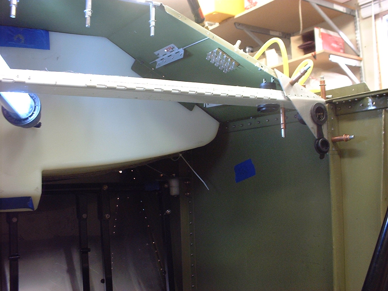

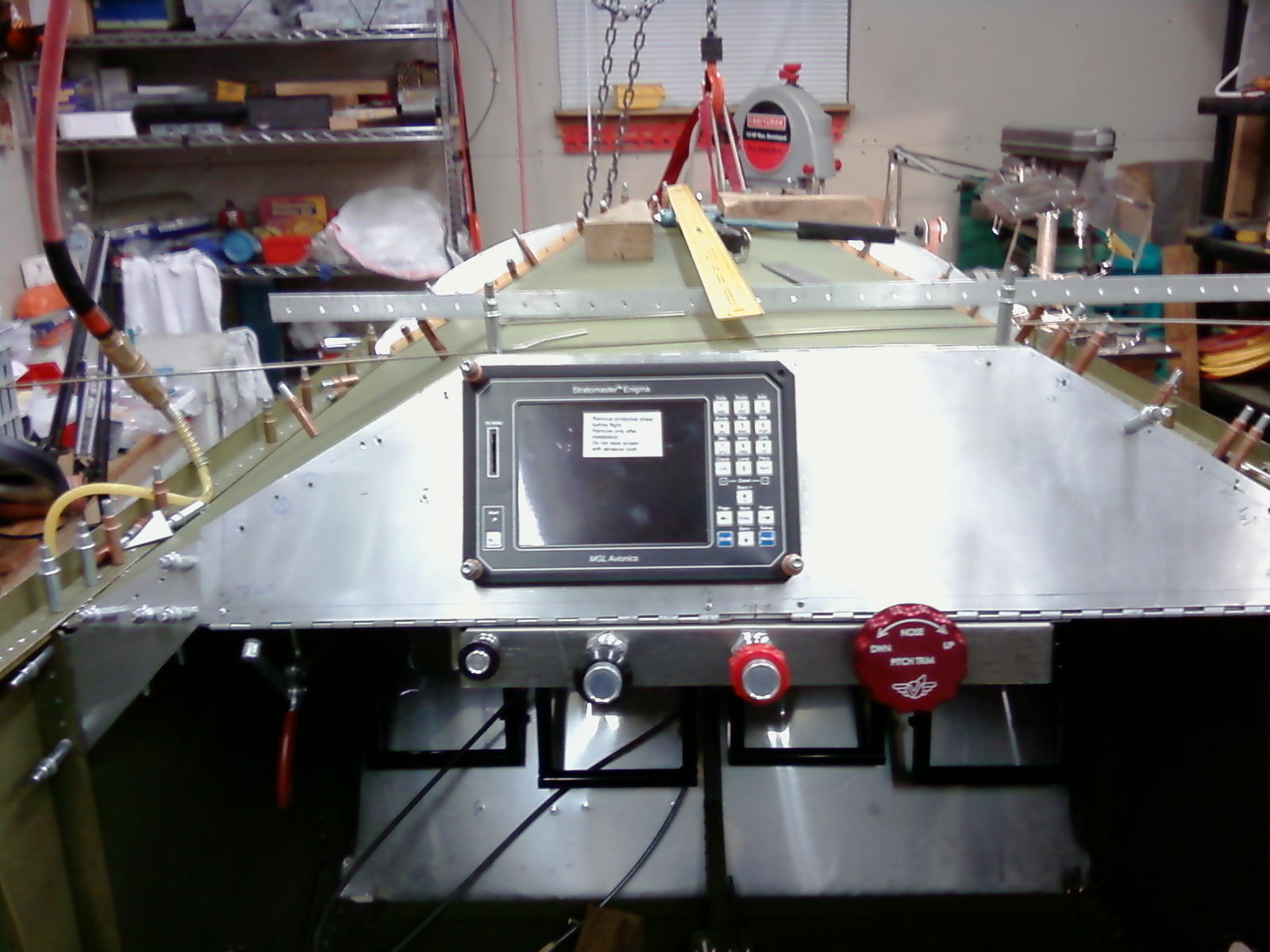

Sounds like I'll get some stranded wire for this. My panel ground is located on the under side of the permanantly mounted glare shield. It's a few inches away from the main buss block, whose piano hinge sections can be seen in the pic.
Regarding the panel ground buss, I have used a section of the B&C forest of tabs. It would be convenient to rivet the brass block to the glare shield and use one of the tabs to connect to the firewall. Would using a faston for 10awg wire here be okay, or would it be better to solder it, or both? I'd rather not have an ugly bolt head on top of the glare shield.
If I solder without the female faston, would I just drill a hole in one of the tabs big enough for the bare wire to go through and solder it like that?
If soldering isn't as good as a ring to bolt connection, I'd prolly make a little standoff bracket for the panel ground.

I will only have 8 or 10 wires to ground in the panel. The section of tab forest for the panel ground has 20 tabs. I may need to get D-Sub tools, supplies, and skills for installing my not-yet-bought radio, but that's down the road a bit. Even if I had the stuff for it, it would only save me a little space, which surprisingly isn't much of an issue in this particular case.
My ground blocks consist of one 48 tab ground block from B&C cut into three sections. 12 tabs are on the forward side of the firewall, 16 tabs on the rear side with a bolt and rivet connecting the two blocks. That leaves a 20 tab section available for the panel ground buss. There's actually no individual grounds going to the rear side of the firewall, just the single wire from the panel ground block. I can't think of anything in the future that I would add that I couldn't ground to the glare shield mounted panel ground buss. So could I eliminate the rear firewall block completely, and just connect the panel ground block wire to the big bolt through the firewall?
Since I have 10awg to the main buss, I understand I need a 10awg ground. I would like to know how soldering this ground wire to a drilled out faston tab of the panel ground forest might work, or if it's better to use a #10 bolt and ring.
