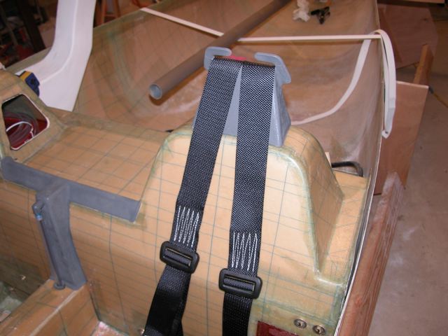

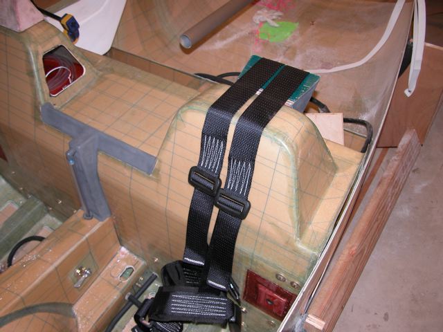

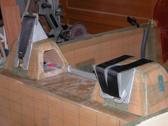

PostPosted: Thu Nov 19, 2009 10:21 am    Post subject: Safety improvement list Reply with quote
Weldone Fred, you culprit!
As I wrote earlier - this is a solution I like!
And it really is madeable to the completed plane without too much pain to spoil everything.
If I asked "would you Fred make an another set of those headrest expanders for me" would you?
If so, I am your customer and #1 in this queue, please.
With that money you can buy real safe safety belts...throw those Europa loop belts to the bin.
Spinal in one piece undoubtedly but still as a looped prisoner Wink
