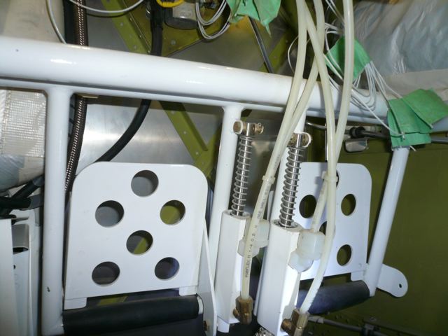

Hi everybody, I'm poking around my long dormant resurrected kit and noticing the right side optional brake pedal lines are white plastic. Does any one sell a kit to do this with nicer lines? Can small AN fittings be used here?

http://www.bonacoinc.com/
I believe they have kits for your RV, but the website has little info
beyond what hose and fittings they have available.

Call Brett at Bonaco, he knows exactly what you need.

On the non pressure side, they are nice as you can see if there is RED fluid
in the lines.
