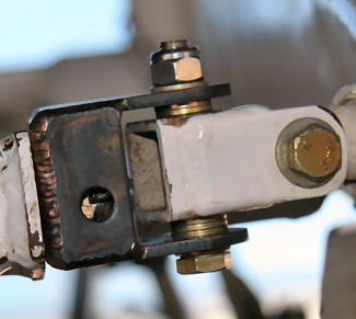

This what you mean? (I took it off and painted it right after this photo
was taken.)

Sorry, here's the photo....

Thanks Robert that pic may come in handy as I also need to raise the
trailing edge of my right wing. (seems a little too common)
I'm actually looking for adjustable horizontal stabilizer hinges.
