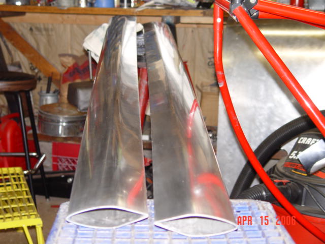

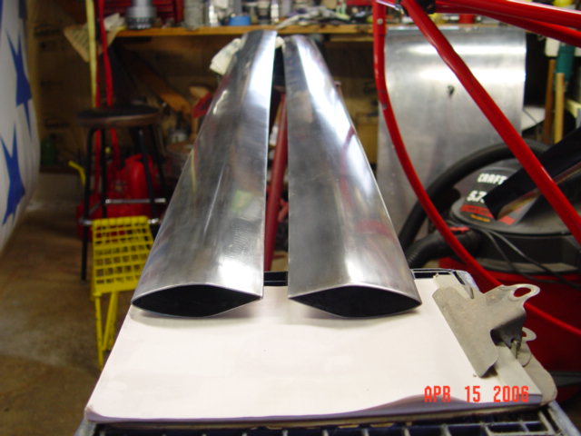

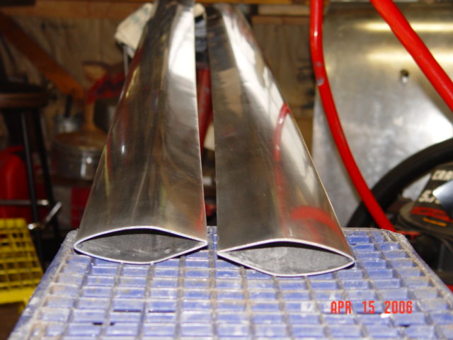

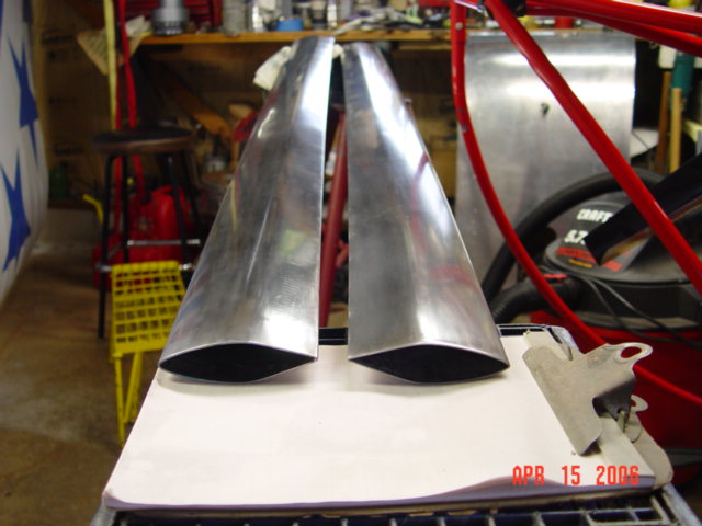

Hey guys,
I've been making some streamline lift struts(sleeves) for my Firestar II
When I fly with the "stock" lift struts...They sometimes start to
vibrate and wiggle in flight.....I bought some aluminum and sheared
two pieces 70" x 9 1/4" ....I put them thru the rollers a few times
until they had about a 20" radius to them,Then with a "knife edge"
and a rubber lower die....I bent them in half in the Break.....
I was experimenting with the TIG , to get it small enough to weld
the seam, I wasn't having much luck with the machine "I" had...So I
used the MIG gun....Dialed it in and had a pretty good bead going.
Then I've been working on cleaning them up and polishing them...
I'm waiting on some AN bolts...Their ready to put on....LATER ,
I'm thinking of making some fairings to extend the streamline struts
to a smoother finish.....I haven't seen ANYBODY try to clean that
area up,I think it looks kind of funny when the streamline just stops...
Gotta Fly...
Mike in MN
PS It was 12 bucks worth of aluminum...and working thru lunches...

PostPosted: Sat Apr 15, 2006 3:12 pm    Post subject: Re: Streamline Lift Struts / (sleeves)Homemade Reply with quote
Fairings turned out great!
What thickness alumuninum sheet did you use?
planecrazzzy
PostPosted: Sat Apr 15, 2006 3:25 pm    Post subject: Re: Streamline Lift Struts / (sleeves)Homemade Reply with quote
Hi John,
Thanks......
I went to the "Discount Steel" down the street from me....I was looking
For anything in their "Drop" section at least 70" x 18"
I found a piece 70.5" x 18.5 it was 1/16" thick ( 16 gauge ? )
Which was about my limit on thickness..... it's a little thinner since I've
used some 220 with a DA , then scuff pad , then 500 grit wet sand....
They can still use some more polishing...But I'm in the ballpark...
I got the directions from your brother "Jim" to make the lift struts like
you have....but I thought I'd try this first.....If it didn't work... I'd only
be "out" 12 bucks...
Gotta Fly...
Mike in MN / N381PM
PostPosted: Sat Apr 15, 2006 3:47 pm    Post subject: Re: Streamline Lift Struts / (sleeves)Homemade Reply with quote
Those fairings over some round 4130 lift struts would probably work well. Be nice and solid.

PostPosted: Sat Apr 15, 2006 5:08 pm    Post subject: Re: Streamline Lift Struts / (sleeves)Homemade Reply with quote
I will be sliding my "stock" lift struts through these "sleeves"....
I will be able to put three ( new, longer ) AN bolts thru the Top of the Lift
strut....but the lower end has the bolts facing towards the rear.....I'm
going to cotter pin those nuts....and cut three inspection holes to see that
things look good..... I fold my plane each time too....
nothing fancy here....just trying to solve the lift strut vibration....
Because the lower bolts don't hold the sleeve....I'll have to see how tight
the sleeve will be , I don't think it's gonna move around...If it does,I'll
put a squeeze on it somehow.... I was thinking about shooting
expanding foam in the gap....but I'm afraid of moister
Gotta Fly...
Mike in MN

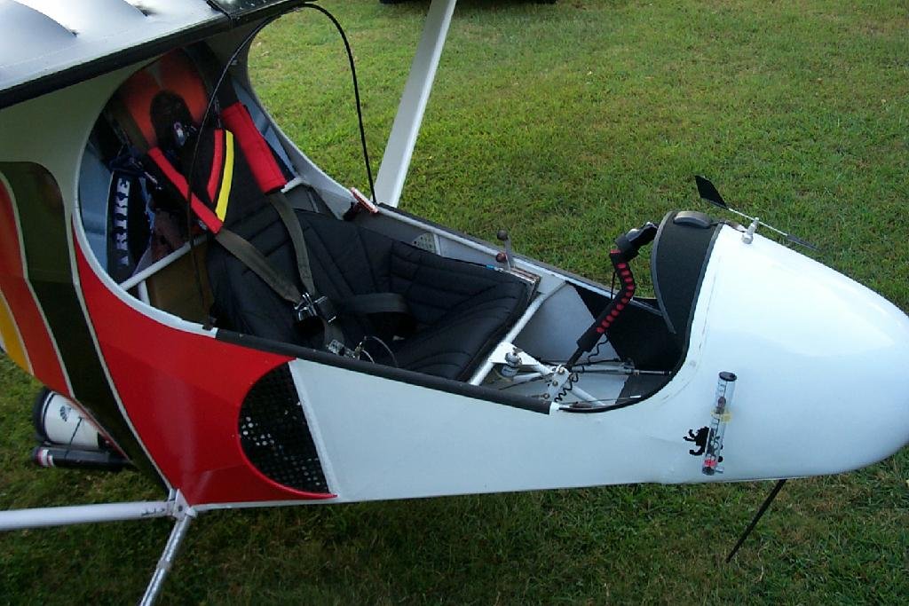

PostPosted: Sat Apr 15, 2006 6:32 pm    Post subject: Re: Streamline Lift Struts / (sleeves)Homemade Reply with quote
planecrazzzy wrote:
Hey guys,
I did almost the same thing - except used a lot thiner alum - rolled the edges just enough to wrap around the top & bottom of the struts 1/2 inch +-, then bent in half with a "break" like you did. Used rivets to attach to the struts. It also eliminated the vibrating strut problem with out adding more tha a pound of weight. T6061 alum - I think?
Don't have any real close up pictures, the rolled edges are hard to see anyway. It make more of a tear drop shape - but the difference in drag is negligible at our speeds.

planecrazzzy
PostPosted: Sun Apr 16, 2006 1:43 am    Post subject: Re: Streamline Lift Struts / (sleeves)Homemade Reply with quote
Nice Job Possum,
I see you were able to put the lower bolts in it ...
