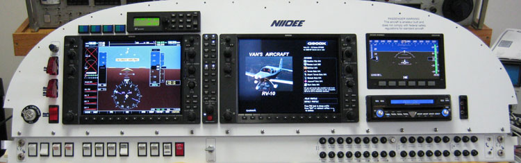

PostPosted: Wed Nov 11, 2009 6:05 pm    Post subject: EFIS backups Reply with quote
I went with the D-100 in my panel including the battery back up making mine a 3 independent battery system. I do prefer the larger screens especially if you are placing your safety on the display.  Also I was able to eliminate the vacuum pump. After 105 hours of flying I am happy with the set up.
Robin
 Filesize:  55.02 KB
 Viewed:  20782 Time(s)
