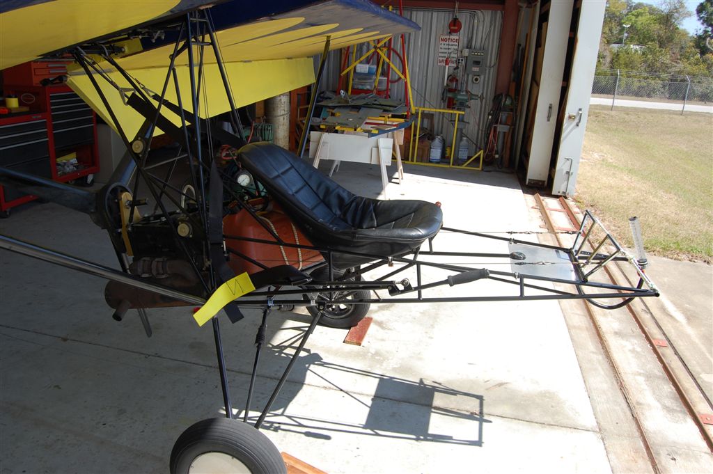

Dana,
When I reconfigured my US I did away with the tank below my knees and
replaced the second tank, which was about a 2 gal. almost triangular
tank located behind my head, with a 5 gal. Exmark ZTR tank which barely
cleared the cables. I'll attach a pic to give you an idea. Seemed to
cut high grass better with a mower tank mounted, too.
Dave

Did you retain the fuel pump?
I guess the first order of business this winter is to order the larger
float needle and measure the fuel flow, then see what kind of tank I can
fit in that space. Where did you get your tank from?
-Dana
larger
I can
-Dana
P.S. What happened to the plane?
Dana,
I kept the fuel pump. I bought the tank from a home and garden center
nearby who deal in Exmarks. The tank is from a Turf Tracer walk-behind
mower. I sold the plane after a windstorm broke a tiedown and bent the
right leading edge. A fellow who has a roofing company bought it, and I
think he's almost ready to fly it. Only heard from him once or twice
since I sold it.
Dave
