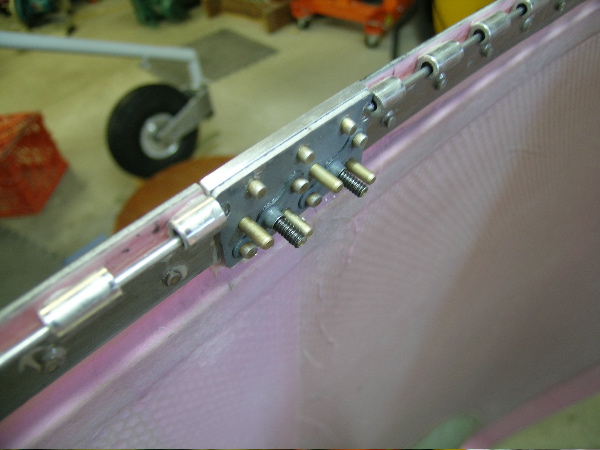

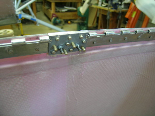

Lastly C I spend five hours redesigning the upper cowl hinge locking mechanism. In my opinion C that thing is a joke. The cowling fiberglass is too thin and when you countersink the #6 screws C it is a recipe for future maintenance and paint problems. The whole mechanism flops around when untightened.  Glue in an aluminum back plate to this area so that the screw holes don't get bigger over time and make a sliding mechanism with #426 rivets. That way when you loosen the #6 screws the plate slides straight down and stays aligned with the screw shafts.
I'll send a photo tonight if anyone want to rack their brain for several hours. At least if you do it from the start you won't have to disassemble it which is part of the five hours.

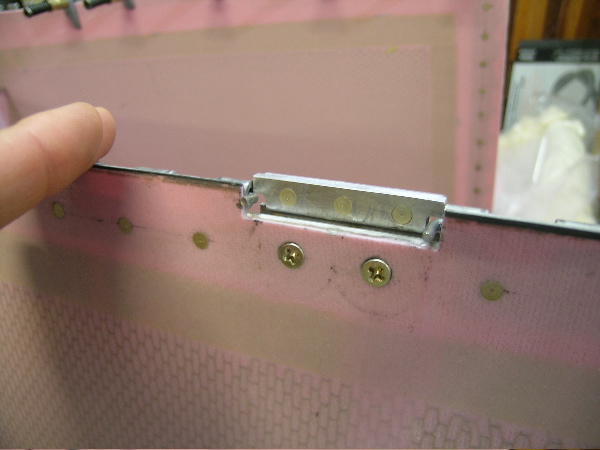

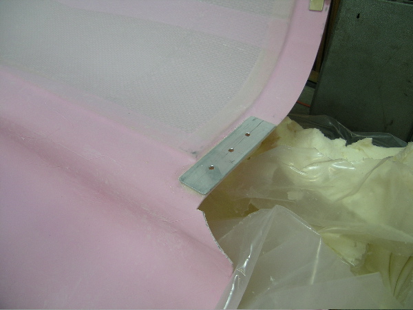

.ExternalClass .ecxhmmessage P {padding:0px;} .ExternalClass body.ecxhmmessage {font-size:10pt;font-family:Verdana;} The idea is that the plate with the nutplates rides along the AN426AD4-6 rivets. The heads of the rivets are sandwitched between the additional plate that acts as a backing plate and is glued to the cowling. The backing plate keeps the screw holes form enlarging and keeps the rivets in place and parallel.
The original design leave the plate that the nutplates are attached to flopping around for and aft when the screws are loosened. It no longer does that.
Use the same plate(the one the nutplates are attached to) that is supplied with the kit C but fabricate a 1/8' aluminum part that engages the pins and levels with the top surface of the cowl. Use nearly 1/16 piece of aluminum for the backing plate C glue this to the cowling after mechanical etch and acid treatment. Use all pieces that came with the kit as drill guides.

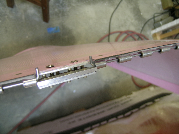

Included a photo of the lower cowl lower attach mechanism C three AN3 screws used per side. Others said that the lower hinge fails after several hours. All hinges and plates are glued with a PTM&W epoxy and the metal was sanded and etched or a sandblaster used for mechanical retention.
