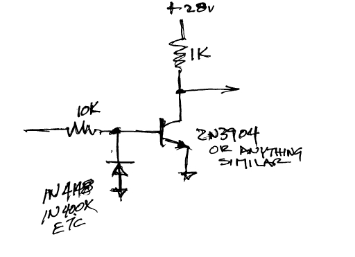

Put a scope on the tach gen output. The situation is the signal from the tach gen goes to a 5.1 V zener diode, then to a comparator against a reference voltage to generate a square wave.
Attached is the picture of the waveform at low rpm (approx 800). Note the spikes in the wave. Also, the voltage is near the zener voltage so the zener never gets driven into breakdown so that is why the unit has a flakey rpm reading at low
rpm.
Agreed.
So, would the waveform squaring circuit you posted in an earlier post work to square this waveform? If so, I have 28 VDC available in the aircraft. I'd need to use a 28-5 V converter chip to get the 5 VDC on the collector as you drew it. Any suggestions for this?
I don't recall exactly what I sent you earlier
but this is probably similar.
[img]cid:.0[/img]
This squaring circuit has a +0.6v threshold. Since
your 80mS, 5v trashy square wave goes above and below
ground, this will square it up nicely. The diode
keeps the negative excursions at high RPM from going
exceeding the zener breakdown threshold for the NPN
device.

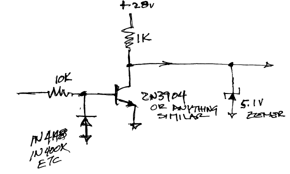

I can eliminate the comparator circuit if I get the output of the squaring circuit to 5 VDC (TTL level). My thought is to use a Texas Instrument UA7805 Positive Voltage Regulator and connect it to an available 12VDC source in the aircraft. This should give me a stable 5.0 voltage source. At 5.0 VDC, the prior squaring circuit diagram used a 4.7K resistor on the collector to limit the current when the transistor is off. This should square off the signal and provide a TTL level input to the EFIS system in the aircraft.
I can build this on a breadboard and test it in the lab and use a variable speed power drill to rotate the tach gen.
If the above sounds reasonable, I'm off to order the parts from DigiKey. Thanks for all the help and advice.
Okay, how about this?
[img]cid:7.1.0.9.0.20091103101407.010d0108(at)aeroelectric.com.0[/img]
How "square" does the signal need to be? If you're driving the
"off the shelf" input to some tachometer originally designed to
attach to a p-lead or some other transducer, the tach should
take care of its own "squaring" internally. It may be that all
you need is to "clean" up the waveform to eliminate bumps and
warts on transitions that can be interpreted as "extra
edges".

PostPosted: Wed Nov 04, 2009 6:50 am    Post subject: p-lead signal conditioning or tach gen usage Reply with quote
Yeah, but . . .
If you study the dynamics of the circuit with the transistor,
it's "active" window is only a few hundred millivolts wide defined
by the signal level where the transistor first starts to conduct
until it is saturated. Only "glitches" that exist within that widow
are transferred through . . . with gain.
A straight divider/zener network has an active window of
about 5 volts but no gain. None the less, the "filtering"
feature we're looking for is degraded. I'm not saying that
it won't work . . . give it a try. But you may find that
the little extra gain and tightening of the window to
be useful and easy to do. By the way, since your signal
of interest goes below ground, the bottom resistor in the
schematic you propose is probably not necessary.

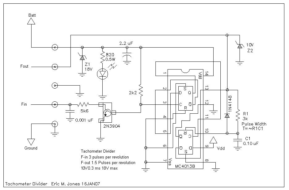

I wanted to repost a circuit that I built for an Aeroelectric lister for his problem of interfacing two different tach generators with one tachometer. This is a simple divide by two and signal conditioner that might prove useful in these, or related efforts.
I have PCBs for this and can build up one for little money.
