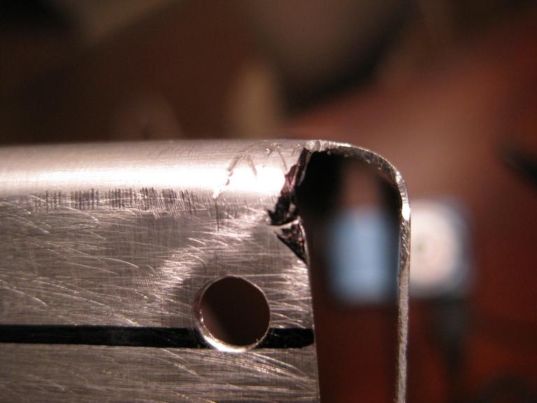

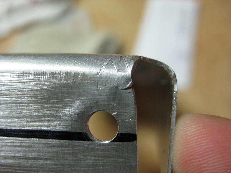

Hey guys,
I could use your expert opinion on this one. I was a bone head and damaged one of my 801 Horizontal Stabilizer ribs to the point I needed to replace it. So, I sent away for the 32 dollar rib with (gulp) 53 dollar shipping (wasn't expecting that one). Anyway, I got the rib and installed it where the old one had been. Went very smoothly. I went to debur the edges and noticed a nice crack in the top rear flange (see first photo). I'm positive I did not cause the crack because there are grinding marks that overlap the crack. There are also some pretty deep tooling marks in that area as well. The only type of pressure I've put on the rib was to clamp it in place, and my clamps would not reach that far anyway. It looks to me that it cracked when it was bent in the form.
Anyhoo, my question is this: Can I remove the area I've marked with a sharpie in the second photo to remove the crack and continue the mission? It's a Number 20 hole and edge distance is already an issue (5mm but should be 8mm) as you can see. The hole on the other side of the flange has a 5mm edge distance as well. The damaged rib I'm replacing had correct edge distances so this new rib has a shorter flange. I emailed Zenair this morning but I think I missed them for the weekend. I leave for Afghanistan in less than a week and would like to finish this part before I go. Thanks in advance.

Jake, take the following comment with a grain of salt - or several grains, if you prefer.
There are two things I could do if this was my project: make another rib myself (with $85 I could make a stack of them!).
Or, cut off the whole area around the rivet hole you show in the picture (a diagonal starting at the top right, where you painted it with the sharpie, going to the left and down), and add a new rivet to the left, with proper edge distance.
Good luck

send it back, that's crap. Shouldn't have been shipped.
John

Jake-- How far are you into your project? If just starting, you should learn to make your own replacement parts, a lot cheaper and saves a lot of time and frustration.
Fritz--- do not archive

Thanks for the suggestions guys. I would consider sending it back but I'm on a deadline so a fix would be better. A fix like Carlos mentioned sounds like a good plan. What do you think about cutting away just enough of the crack to get rid of it - Then add an L bracket on the inside of the flange that is long enough to have the proper edge distance using the same holes? I would rivet the L bracket to the web with the same number of holes and spacing as used on the flange and spar.

Not too far into it. My rudder is complete and I'm just getting ready to finish the Horizontal Stab. I can't argue with you on that one Fritz. I've been looking around locally to find 6061 but have come up empty handed. With Gulfstream 5 miles from my house you would think I could find some. Everyone I've talked to seems to get it shipped in.

Jake, I'm not sure how far away it is from you but Aircraft Spruce is in Peachtree City, GA. I'm sure they have lost of 6061 in stock

6061 T6 is pretty common. Often used when fabricating aluminum service truck bodies, semi trailers, etc. Thickness (or lack thereof) may be a problem though. As a scratch builder, it is also easy for me to say, Get some material to re-fabricate parts, you will need it. I agree, it will be worthwhile to learn the skills to fabricate parts. Otherwise the project will take longer, waiting for parts and will cost more. Do the 801 plans give enough detail?
BTW That piece does look poor.

The 801 drawings do not give any detail on part dimensions.  I would need to reverse engineer them. Not rocket science but more of an undertaking than if I had templates.
I've had trouble with several parts since the start of this build.  Only with holes being drilled off-set from where they should be, never with actual damage to the part. For instance, on the rudder spar, the lines of pre-drilled holes were several mm to one side all the way along the spar. My elevator skin had holes drilled closer to the edge on one side than the other with edge distance less that was needed. The company came up with an acceptable solution but I ended up crimping the leading edge when handling it, so I'll buy another skin before moving forward.  Several parts were replaced early on by the good folks down at Flight Crafters in Florida. I purchased my tail kit through them and they dealt with Zeniar to replace the parts. Since then I've talked directly with Zenair on several occasions and they have been nothing but helpful on the phone and email. I realize the kit production was moved from Zenith in Missouri to Zenair in Canada recently and I'm chocking these early problems up to growing pains.
One thing I would like to stress is I'm not unhappy with the 801. I understand that building your own airplane is an exercise in patience and reasoning. We need to keep one eye in the AC43.13 and one eye on what we're told on this list and by the company. I don't expect everything to go together perfectly and if the company can come up with an acceptable and strong solution to a problem with a part they sent me, or a screw up I've made, I'm open to it. Thanks again for the support guys, I appreciate it.
