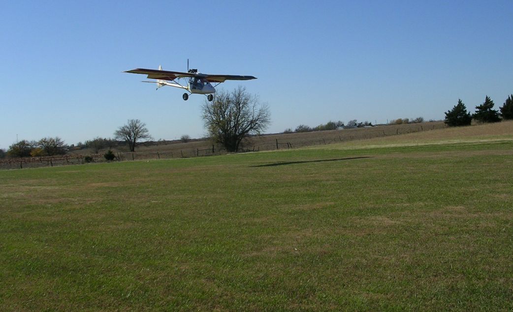

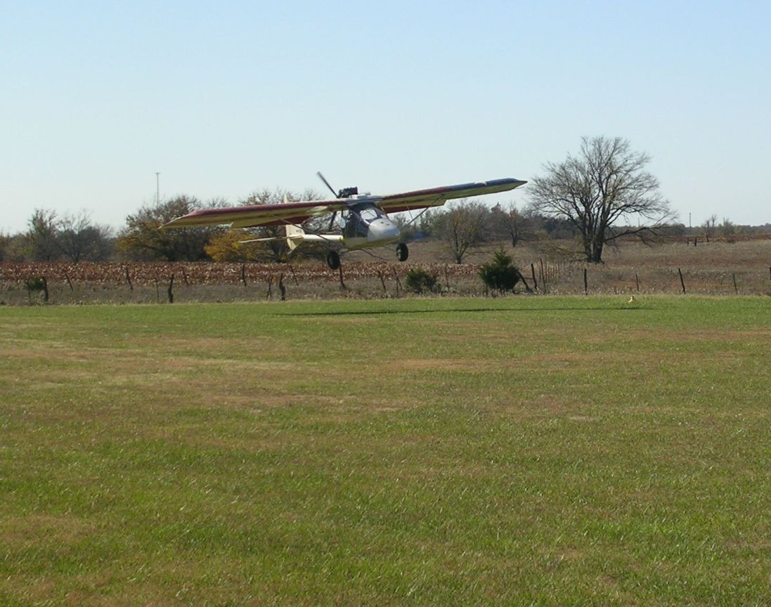

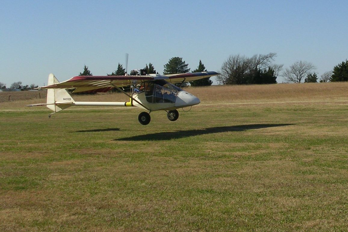

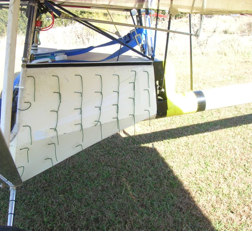

After the chickens and guineas were loosed, the dog walked, and the second cup of coffee, I hit the hangar determined to get two projects done. One, build a camera mount to go on the top of the left strut and, two, tuft up the left side of the fuselage and go fly around and film the tufts. The camera mount was pretty straight forward, just a couple of pieces of aluminum angle and a few holes. Tufting up the fuselage didn't take long and by the time I had Zulu Delta all fueled and ready it occurred to me that my neighbor, John, had asked me about how the Kolb landed with flaps. Seemed like a great way to get him to take a few pictures so I did a half flap take off and landing then a full flap landing after which I departed the pattern to go see if my first attempt at aerial videography would net me anything. The little Nikon did great although the contrast when the camera was in the shade and I was backlighted was a bit too much to ask. The tuft study was done at airspeeds from 62 to 84 mph and confirmed what I suspected. The sides aft of the pilot on the Mk IIIC are pretty much stagnated or otherwise disturbed. only the most aft tufts showed straight flow going into the prop. In the middle of the panel all the tufts point upward at ever increasing angles as speed increases. Those just behind the widest point of the fuselage are very disturbed. The two upper ones got entangled almost immediately and stayed that way throughout the flight regardless of speed. The most curious was the lowest tuft in the second row aft. It pointed forward no matter the speed while both the ones immediately forward and aft of it were pointing aft and up.

Nice pictures ! Second...do you think VG's would help the cabin side area??

Get some VG's some tape, and stick them in various places on the doors, fuselage sides, etc. And film all of them. You might get lucky.
At worst, it would be like feeding crackers to a dead man...couldn't hurt much... Tell everybody you're on an FFF project - flyin', filmin, and foolin around... As long as you can annoy Al Gore by adding CO2 to feed the cabbages it's all good...

<STOL lift off 3 resize.jpg><Half flaps and slippin resize.jpg><full
flap roundout 1 resize.jpg><All tufted up.jpg>
