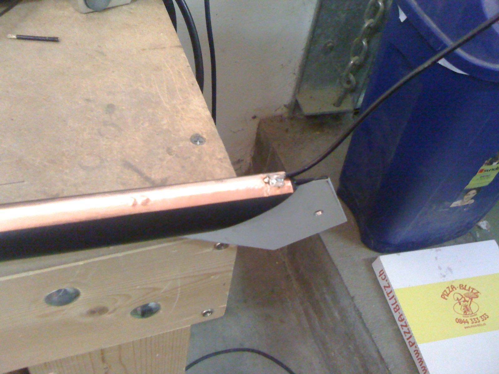

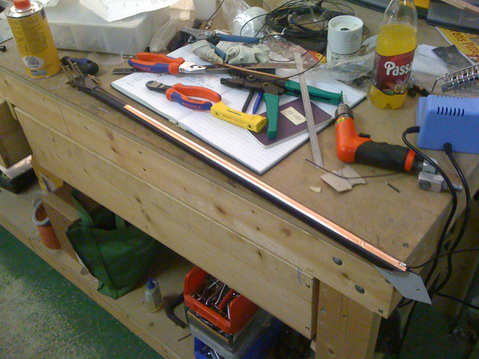

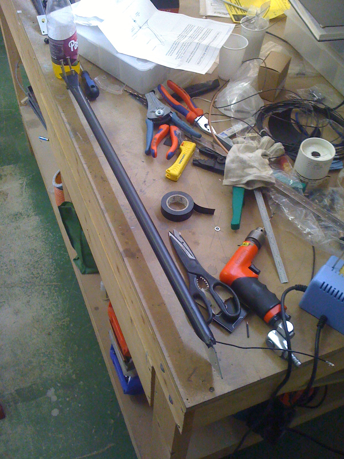

I just wanted to share my first positive experience with the windscreen antenna taped to the center bar. I tested it by holding the center bar at the right angle and attached my handheld radio to it. I had no problems listening to Zurich tower although being inside a concrete building.
I glued the strip to the bar and covered it with black tape (see attached photos)

Help me with this please - I had one similar - on the windscreen. Had it
tested by a bunch of HAM radio guys - they said it was too short causing the
SWR to be bad. I had made it longer in hopes of cutting it doen during
testing. It seemed to receive OK but couldn't get anyone to hear me.....
How long is yours?
Have you tried it in flight?
What led you to taping it to the center post?
Is it insulated from the center post only by the paint?

My antenna strip is about 23 inches long but plus the cable its more like 24
reception is good but I didn't try to transmit yet.
The center bar is powder coated in flat black on top of the original gray.
Mike

PostPosted: Mon Nov 02, 2009 6:43 pm    Post subject: Re: First successful test of windscreen antenna Reply with quote
Because the center post is attached to the airframe, it is grounded. Having your antenna tightly attached to a grounded piece will probably de-tune it significantly, or at the least cause an odd radiation pattern on transmit.
I expect you will not find this antenna to work at all well.
It is recommended that you install the foil strip type on the inside of the fiberglass roof, where it is away from the metal of the airframe. Comm antennas need to be vertically polarized, so the best location is on the door post immediately behind the door. I have such a foil antenna for my handheld installed there, and it works well. (But for the main Comm, I rely on an external Comant on the belly, cause I know it will work well.)
