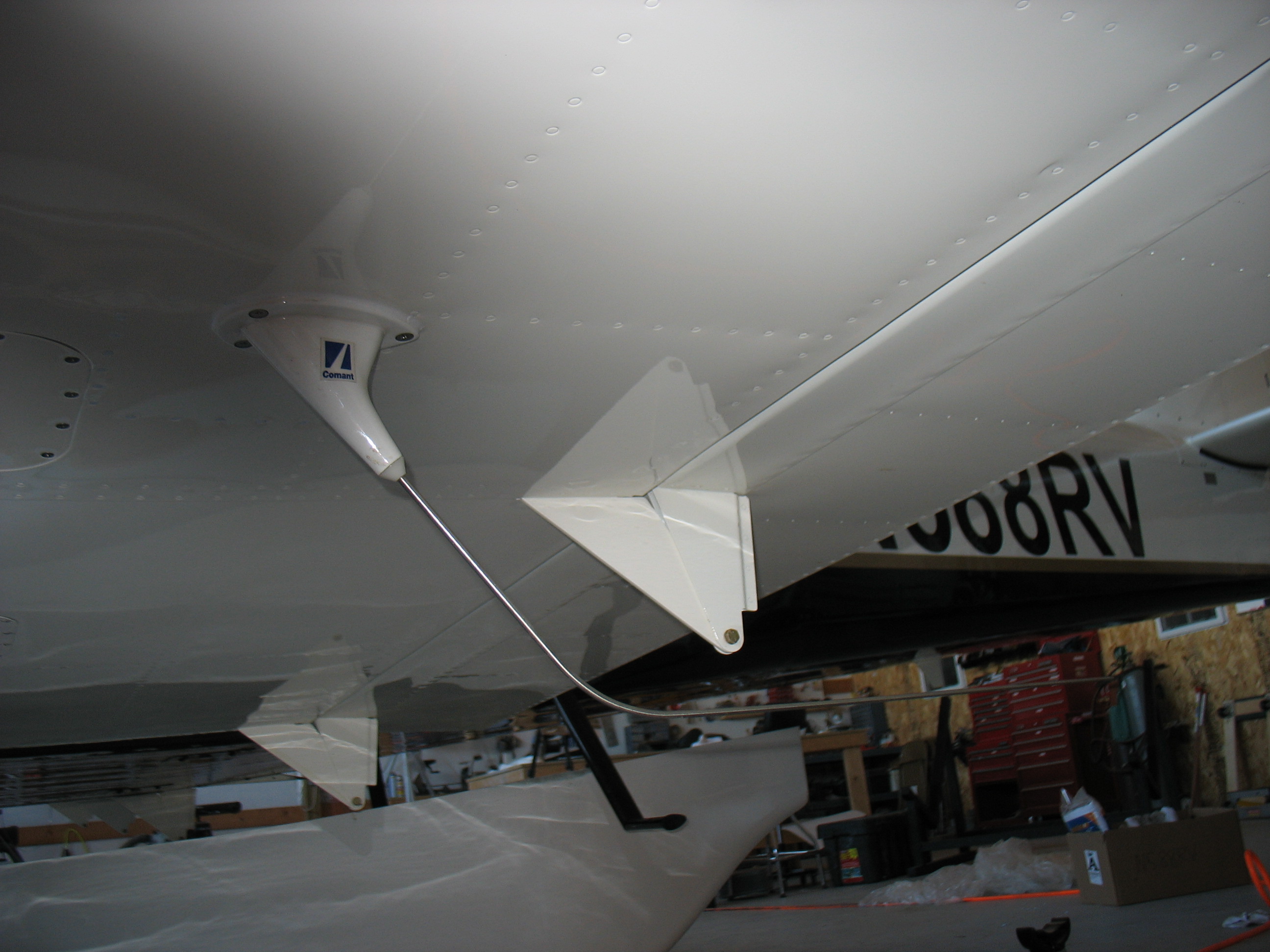

David Shelton
Joined: 26 Aug 2009
Posts: 22
Location: C77
PostPosted: Mon Nov 02, 2009 8:31 pm    Post subject: Re: Antenna Location Reply with quote
We relocated my bent whip antennas to make room for my belly pod. The avionics shop installed doublers and mounted them immediately behind the wing plates. The particular doubler design was not easy to fabricate but it ties into the structure and makes a very strong mount. They seem to work very well at that location and I haven't had any trouble with my radios.
If you E-mail me (MotoPOD(at)gmail.com), I can try to scrounge some more detailed photos for you. -David
