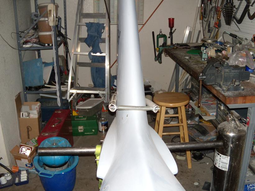

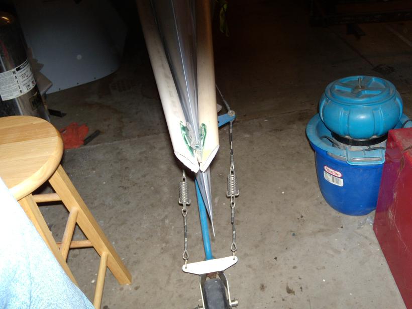

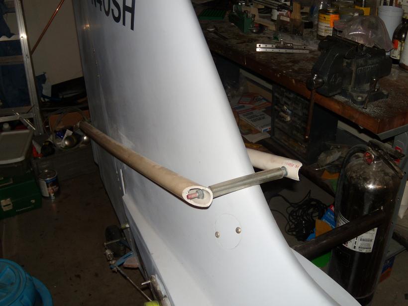

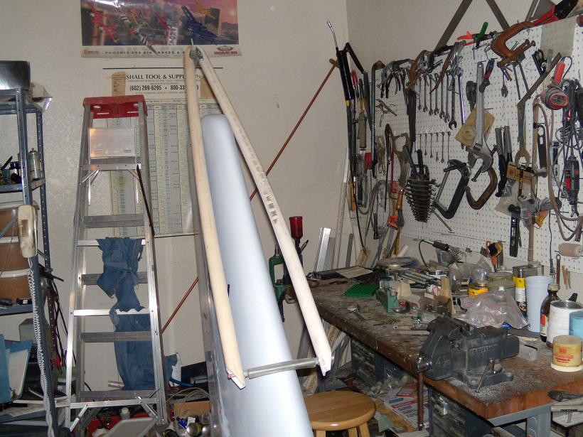

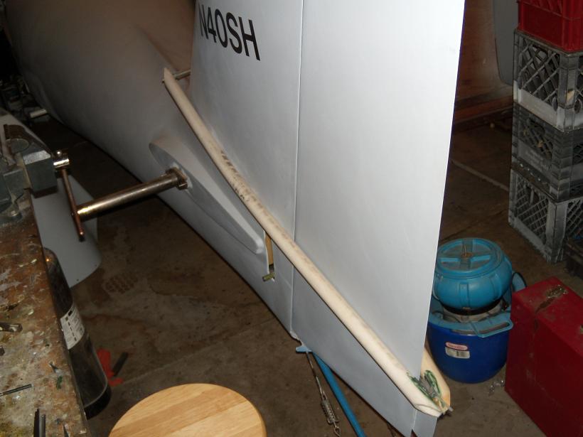

PostPosted: Sun Nov 01, 2009 6:45 am    Post subject: Rudder Lock Reply with quote
See attached photos
PVC. some all thread, rubber tubing, and a bolt.
Tested out, effective, no hassles
Steve Hagar

jeff(at)rmmm.net

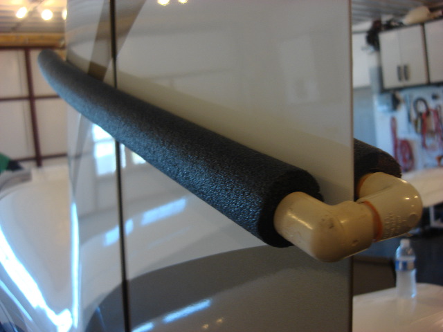

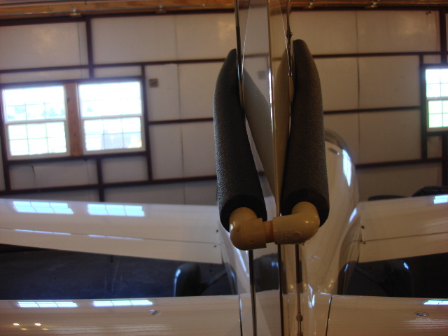

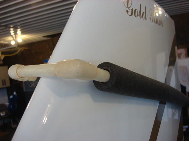

PostPosted: Sun Nov 01, 2009 9:44 am    Post subject: Rudder Lock Reply with quote
Frans,
I did something like Steve did. I will eventually refine it to ride
lower but I don't tow mine. The foam sleeves protect the paint.
Jeff R.

JEFF ROBERTS wrote:
Frans,
Nice to see that everyone comes up with an almost similar solution. Mine
is not much different, except that it rides lower, and because the fin
ends there, I have to insert a bolt through the trim slot to keep both
halves of the lock connected.
If I did not intent to trailer my Europa, I would probably have made
something that can be just hang over the rudder and fin, like most
others do.
Frans
