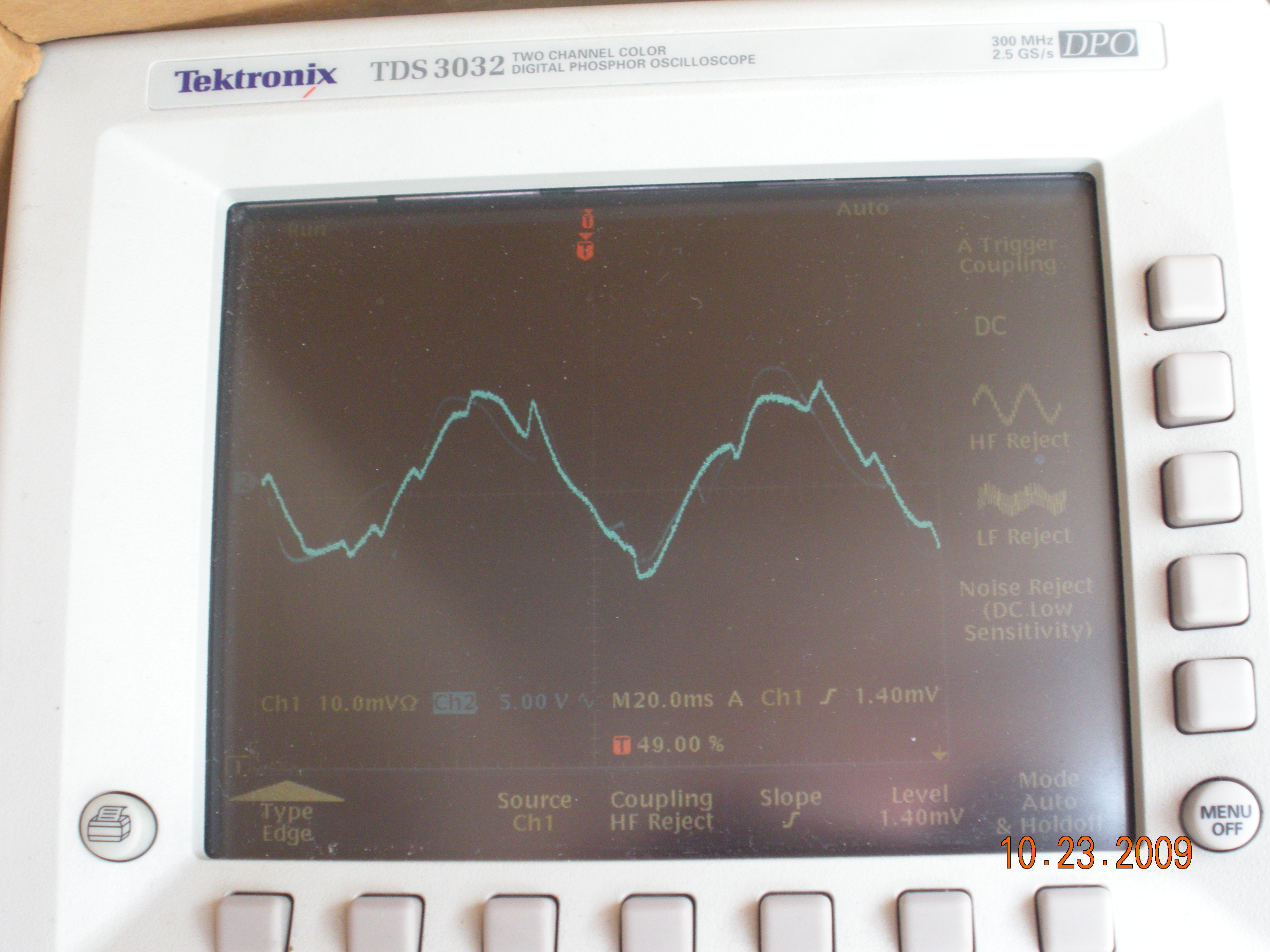

We are putting a scope on one phase of the tach gen output and the
p-leads tomorrow. I'll take a picture of the scope as this will help.

Put a scope on the tach gen output. The situation is the signal from the tach gen goes to a 5.1 V zener diode, then to a comparator against a reference voltage to generate a square wave.
Attached is the picture of the waveform at low rpm (approx 800). Note the spikes in the wave. Also, the voltage is near the zener voltage so the zener never gets driven into breakdown so that is why the unit has a flakey rpm reading at low rpm.
So, would the waveform squaring circuit you posted in an earlier post work to square this waveform? If so, I have 28 VDC available in the aircraft. I'd need to use a 28-5 V converter chip to get the 5 VDC on the collector as you drew it. Any suggestions for this?

Forgot to mention that at full RPM (2400) the tach gen signal is a bit more than 40 v peak to peak.
