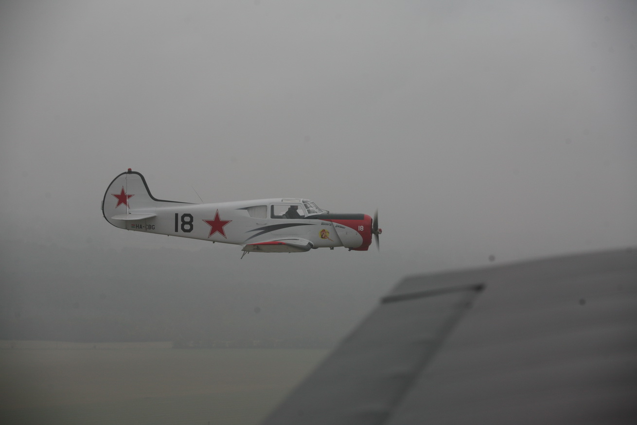

Hello to all,
first of all I must tell you that I had a very good day together with my friend Christophe Bourillon owner of a superb YAK18T (see the picture attached). As you can see the weather in Normandy France, was.....not very good today but we, yakees, use to fly nearly anytime...that's a joke of course. If you read this Christophe thanks for this very nice day.
