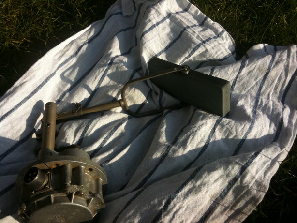

4)I have fluctuations in my gauges indications. It seems that it could come from the floatters. Do you know if it is possible ti find these foam floatters or to repair it or to find the gauges (picture are attached)
Thanks so much to all for any hints and tips.

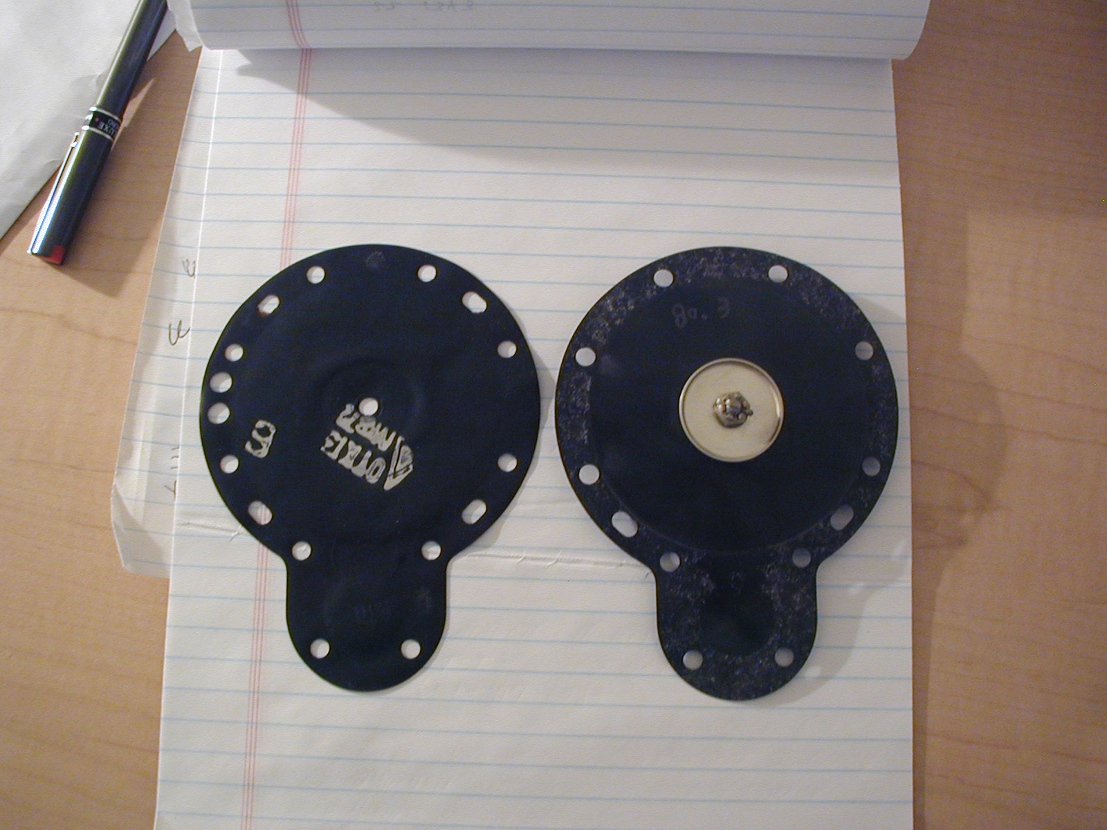

Doug,
The carburetor diaphragm for the M14 is slightly different than the one on the Housai carburetor and are not interchangeable "out of the box". In the attached photo, the M14 carburetor diaphragm is on the left. I'm sure by using a proper size leather punch and overlaying the diaphragms, one could punch out the additional holes in the Chinese diaphragm and adapt it to the M14 carburetor.
Dennis

Hello Didier,
in the West London Aero Club inventory the diaphragm is still listed, I had one from them one or two years ago. The exchange rate from Pounds to Euro is great and you may save a lot for shipping from UK if they still have the part on stock, of course.

Vic,
sounds interesting. I definitely will try to change the foam and clean the sensor before changing all the parts.
And I runned the check you are describing (moving the float outside the tank) and the sensor seems to works just fine.
thanks very much for your input
kind regards
Didier
