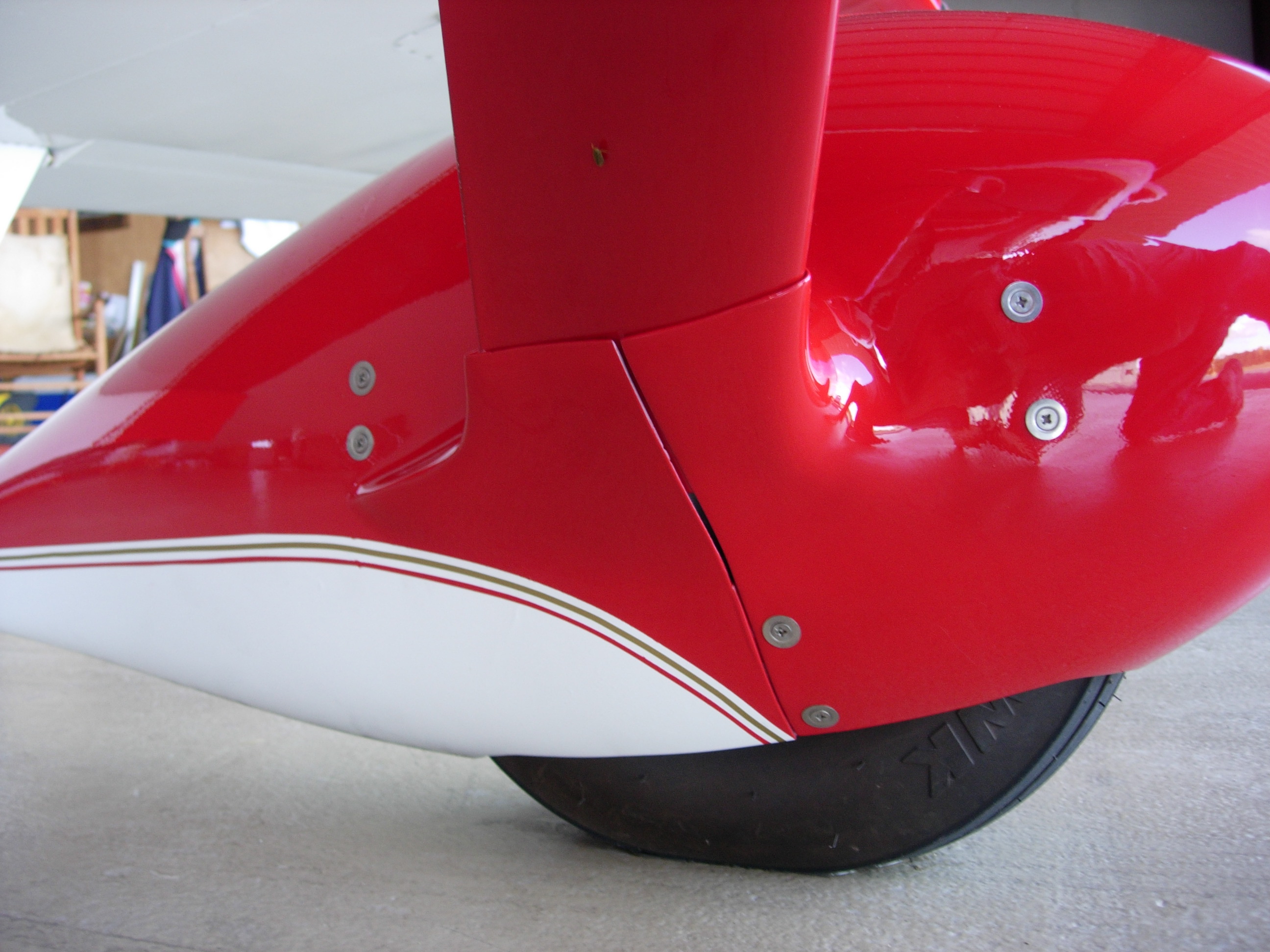

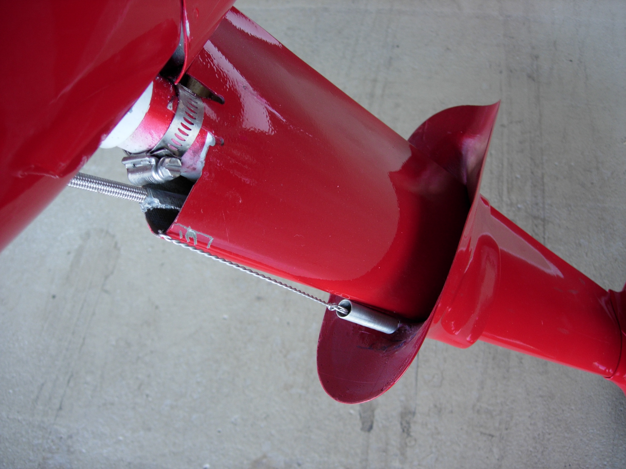

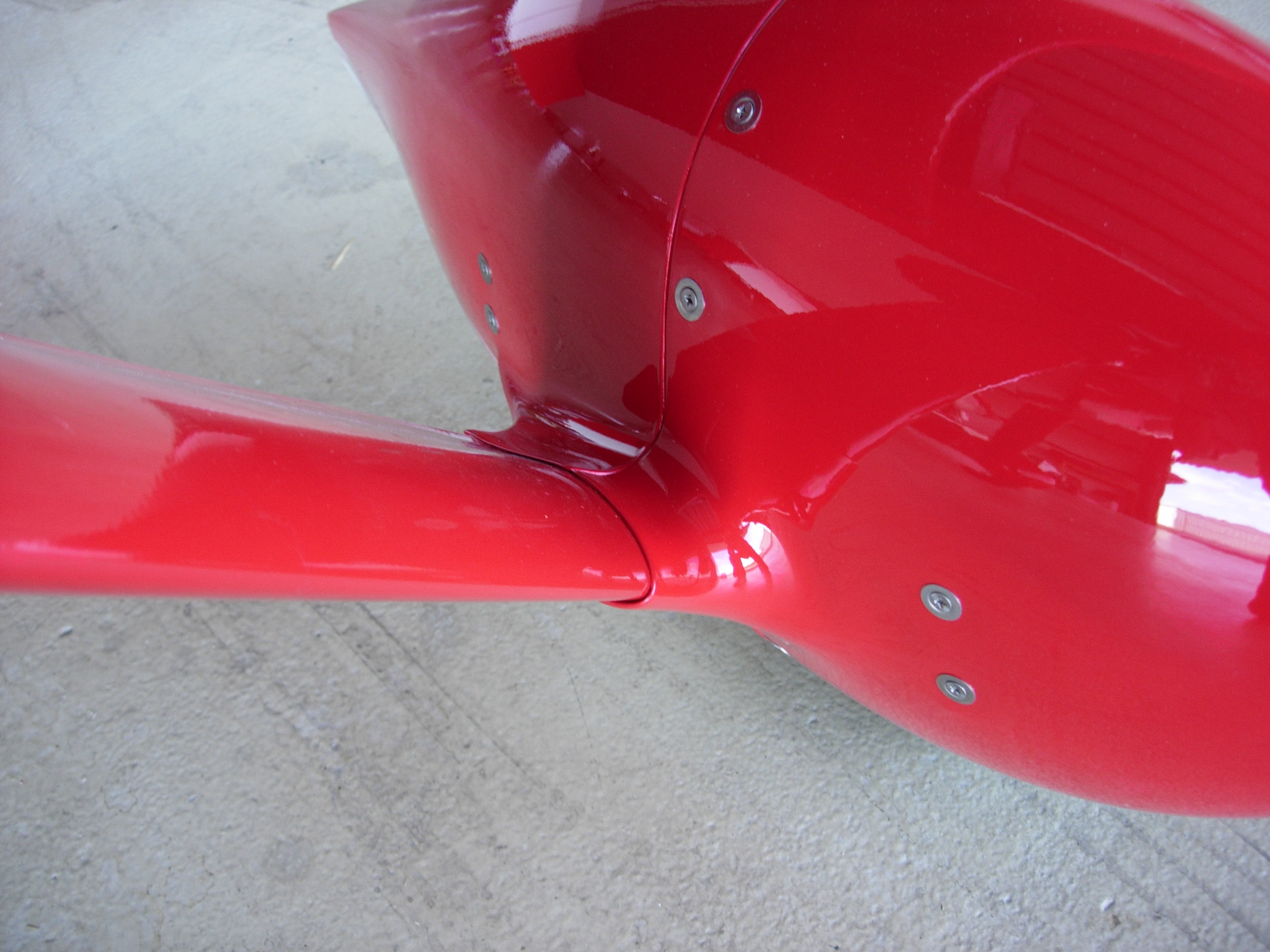

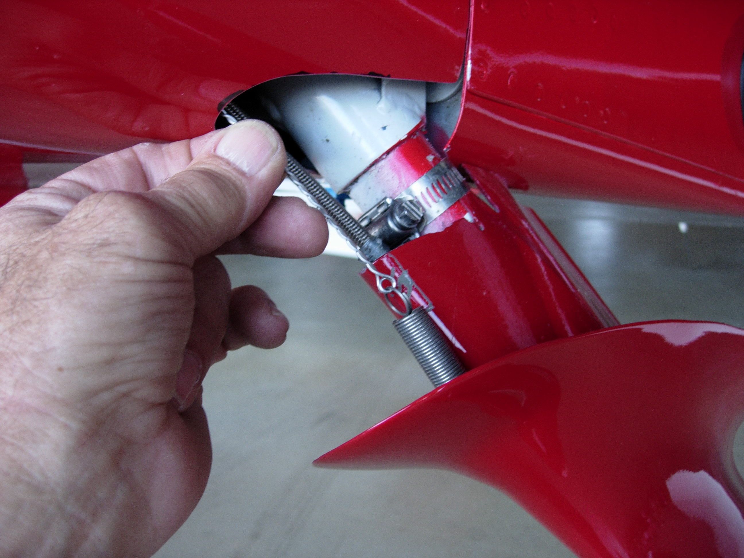

the bottom fairings are bonded to the wheel pants. The top fairings are pull against the fuselage with a spring,the fairings were formed over shaped modeling clay with 4 layers of fiberglass.I did 1 rv6 and two rv7 that way the 3 aircraft are a shiloh ,SIF,if you like to come and see them .
Tomorrow I will make pictures to send you
Andre

PostPosted: Thu Oct 29, 2009 5:06 pm    Post subject: on fairings Reply with quote
pictures attached
Andre

PostPosted: Thu Oct 29, 2009 5:09 pm    Post subject: on fairings Reply with quote
more pictures
Andre
