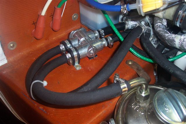

I had the same issue with the oil temp being too low on my 912ULS. I also
had too low coolant and cyl. head temps during the cold season in Norway
(50/50 water/glycol).
I fitted the Rotax recommended thermostat - big improvement (see attached
photo).
I also fitted a Van's cooler shutter in front of approx. 60% of the air
cooler (see attached photos, taken before I removed the metal plates in
front of the lower part of the oil cooler when the thermostat was
installed).
40% of the air cooler is left open so that I always have air stream into the
pick-up duct behind the coolers for cabin heating (a shutter in the back of
that duct is closed in order to press warm air into the cocpit).

steven.pitt2(at)ntlworld.
PostPosted: Fri Oct 30, 2009 1:50 pm    Post subject: Oil cooler thermostat and air cooler shutter Reply with quote
Svein,
I am not able to find more detail on the oil thermostat to understand how it
works and is plumbed in. Can you point me in the direction of details.
Thanks for your input.
