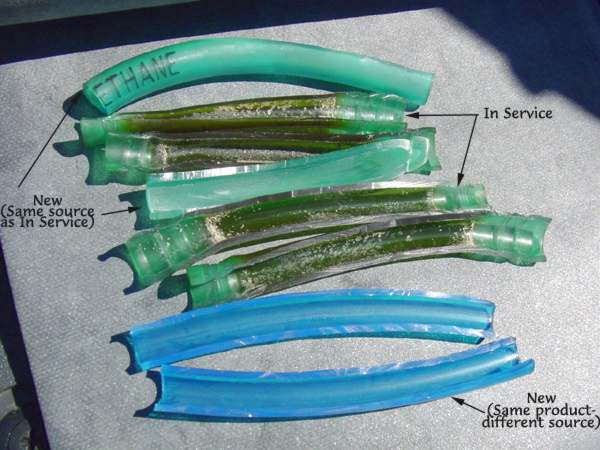

I have warned many times in the past on this list against using the cheap, clear fuel tubing in any airplane. It is very fragile, easily pinched, easily punctured, and prone to failure in a number of ways. My lawn mower came with better fuel tubing than most people use in their Kolbs...
http://forums.matronics.com/viewtopic.php?t=48298
Those that continue to use cheap fuel line run a lot of needless risk for nothing. It is easy to change to quality fuel line, and does not cost much. I use Aeroquip fuel line in my Kolb, and have also used the expensive $3.50 dollars a foot High Pressure fuel injection line from Napa in other airplanes. They are both very good. The cheap stuff from Napa that is about $ 1.50 a foot is not good, pinches and crushes to easily, the fuel line from Advance Auto Parts is even worse. I do not and would never have any clear, " toy type " fuel tubing anywhere in any of my planes.
Mahesh, you can buy all metal fuel pickup tubes from Kolb which would be better than what you have now. For those that do not see the entire account of the engine failure, you can read it here.

For those that use the forum, here is Mahesh account that did not show up on the forum:
Dear Kolbers,
I wanted to share my experience of a forced landing that I had last weekend
I took my Firestar-2 for some take off and landing practice and some flight
around the around the valley. I had gone through a complete preflight, run
up, full tanks of fuel and had three takeoffs and Landing in the pattern.
On my fourth take off I climbed to pattern altitude and as I was turning cr
osswind, I felt a bump and pretty much thought that it was a Thermal below
my wing and continued turning down wind. After my turn, the RPM dropped sud
denly from 6200 to 3200 and a chill ran through my spine. I immediately rea
lized that the engine is going to quit! It ran rough and the RPM was oscill
ating up and down. I wanted the prop to keep spinning and not quit, so I im
mediately got my throttle to idle 2300 RPM and just forced the nose down an
d increased airspeed to 68MPH. I made a quick and short turn to base and th
en final and set myself up for landing. When the prop was spinning with min
imum forward thrust, it felt as If I have thrown a drogue chute out.
I came in nice and made a good three point landing and there was enough po
wer to get me to the taxiway.
I went through a RPM check after parking and as soon as I increased the thr
ottle, I engine completely quit and the prop stood still.
=C2-
I started to trouble shoot and these were my observations:
=C2-
There was no fuel present between the tank pickups to the Diaphragm fuel pu
mp to the carburetor.
The carburetor bowls had almost run dry
=C2-
The was a fuel starvation and hence the engine quit. I started tracing the
fault and had the following possibilities =93 Failure of the fuel pum
p, or failure of the Primer bulb (Check valves) or after discussion with my
friend Roger; it could be an air leak in the line.
=C2-
I replaced my primer bulb with a new marine one, but it did not help. When
I started to pump the primer bulb, it was not pushing the fuel up to the fu
el pump. On further trace, I found that one of the pick up tubes in one of
the tanks had given way.
=C2-
The problem:
I have two fuel tanks (5 gallons) each. I had modified my pick up, such tha
t I passed a short piece of urethane tubing attached to the fitting and the
n inserted a metal pick up tube that extended right to the bottom of the ta
nk and had the entire arrangement safety wired. The blue urethane fuel line
being in continuous contact with fuel, became soft and gave way with time
(2 months only) and the metal pick up dropped to the bottom of the tank in
flight. Since I have tee,ed the two pickups from both the tanks, the failed
pick up started to draw in air and stopped fuel flow, resulting in fuel st
arvation.
=C2-
The improvement:
I modified and reinforced the metal pick by running the =C2=BC=9D ure
thane tube right over it to the end of the tank such that it will never fai
l and provided safety wiring adequately.

PostPosted: Wed Oct 28, 2009 7:21 am    Post subject: Re: Engine quits in Mid flight -Forced Landing- Fuel starvat Reply with quote
John Hauck wrote:
I don't know what the draw to clear plastic fuel line is with ultralighters,
other than the standard answer, "I need to see my fuel." Wink
You are very correct John, people parrot this line and have no understanding of how flawed and dangerous their reasoning is.
There is no need to see the fuel going through the line in any vehicle, be it cars, boats, or airplanes. No certified or LSA airplane in the world has clear fuel line so that you can see the fuel going through it. It is nothing short of ridiculous to think you need to see fuel going through the lines.
There are those that will say " I need to see the bubbles if there is a leak "... The best answer there is to have a properly designed fuel system that is pressure fed rather than vacuum drawn. If you are drawing fuel through a vacuum, then you are asking for vapor lock that will result in engine problems / failure, or complete engine failure due to the slightest leak. With a pressure fed system and quality fuel line, chances of a leak is about a thousand times less than with clear fuel line, and if you do have a leak, you will see a slight wet place on the line instead of having an engine failure. Many very smart aircraft designers have been designing fuel systems in airplanes for over 100 years now, and no manufactured aircraft use cheap clear fuel lines. The risk in using cheap substandard clear fuel line is FAR greater than whatever imagined benefit that ultralight community has come up with.
People definitely imitate lemmings sometimes, things get started in small communities like ultralights, and its monkey see, monkey do... People just like follow whatever everyone else does without questioning it, even if its leading them off a cliff...
Mike

JetPilot wrote:
George,
There is not (sic) such thing as clear fuel line that even comes close to the safety and quality of Aeroquip or High Pressure fuel injection line.
As a simple statement, who could quarrel with that? However, safety and quality are relative to the application. I am satisfied that the quality of the clear line that I use exceeds the requirements for my application and I feel that it is safe to use on my aircraft. You may say/think otherwise. That's your right.
BTW, in my fuel system, only the inside walls of the fuel line come in contact with the fuel/oil mix. None of it is submerged. My tanks are bottom feed.
JetPilot wrote:
The fact that you feel the need to change your fuel line every year is an indication of how substandard the stuff is, it does not matter what you paid for it.
Bad assumption, Mike. In spite of what you may think of others' intelligence, if I felt it was substandard, I wouldn't have it on my plane.
The reason that I change it annually is the same as the reason that I use it in the first place. It is "clear". Running fuel/oil mix through it, age/time, sunlight all create discoloration. Discoloration reduces the "advantage" of being able to see through it.
Witness a condition that Beauford discovered with his system. Being able to see the build up of an unknown substance on the inside wall of his fuel line, may have, repeat, may have, prevented an engine out. (See attached photo.) If any of that crud had made its way to the bowl of his single carb, R447, he very likely would have heard only the air rushing over his VGs.
I have since seen a similar (not quite as severe) build up in my system. Beauford and I use different fuel line, use fuel from different sources, we do both use the same 2 stroke oil (as does a large number of the 2 stroke engine operators) and both pre-mix. The only common denominator for us is storage of our aircraft in very warm (sometimes damned hot) conditions here in SW FL. While it is a guess, the heat may be the source/contributor to the crud. Heat, fuel additives, etc... who knows. Only know that the crud was there and it was seen through the clear fuel line and would have not been seen with non-clear line.
Hope your storage facility is nice and cool. Your mean temp in South FL is about 5 deg higher than ours.
Jet Pilot wrote:
How many cars do you have to change the fuel lines out once a year , How many certified airplanes do you have to replace the fuel lines every year ?? None, because no manufacturer would risk building such a substandard safety item into an item that is sold in the open market. More importantly, the clear fuel line would not pass any safety standard in either cars or planes.
Your analogy to cars or certified airplanes and their applicable standards. Do cars and certified airplanes have the same criteria for safety/operation standards? Do all cars and all certified airplanes use the same fuel line? Are compression checks required on auto engines every year? No? Different standards based on the application maybe?
Jet Pilot wrote:
Even if you do change your line out once a year, the cheap clear toy fuel line is still very fragile, prone to crushing and a number of other things.
Admittedly different grades of fuel line are available. Some I wouldn't put on the aerator of a tank that housed fish that I didn't even like. But I'm not sure how I can make it any clearer. I DO NOT USE, nor do I recommend the use of "cheap clear toy fuel line". Your inference is that all clear fuel line is "cheap clear toy fuel line." I believe you to be mistaken and misleading to readers.
Jet Pilot wrote:
I fully support your right to make your own choice in fuel lines.
I appreciate your support of my rights.
Jet Pilot wrote:
I hope you keep a close eye on it, keep changing it, and have no problems.
Not to worry. It is my duty to myself and my family to keep a "close eye on it" (that's why I like clear!), keep changing it (so I can continue to see through it!) and keep it at the no problem level to the best of my ability.
Jet Pilot wrote:
But most importantly, everyone should have the facts about the disadvantages and dangers of this type of fuel line and make an informed decision instead of just copying what other ultralights do.
And as long as there is a multitude of contributors to this list, who are willing to share their experiences/views/etc..... the reader will have to glean "the facts". With the various views that are presented, I am confident that most people understand that there isn't any one individual who has a corner on the "facts". Not even if they be ultralighters who bend tubes or jet pilots who overshoot their destination by 150 miles.
I'm done! Not worth nearly what you paid for it!
Fuel line samples
