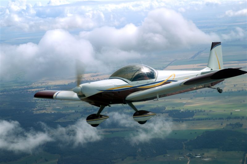

There is a XL601 flying here in Australia with RV wheel pants and it looks great.
This aircraft recently won an award at our annual Sports Aircraft Association of Australia Fly-in.
The aircraft is owned by Peter Franke who is active on these lists so I am sure he will be able to give you more details.
Greg Cox
Sydney Australia

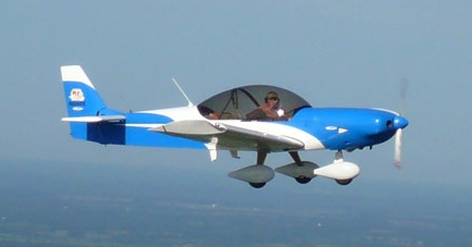

Mains are Vans with RV-8 attach kit. Nose wheel attach kit with a main wheel pant on the nose. Went together almost like it was made for the Zenith.
-Gus

Gus,
Was that with Zenith or Grove gear?
Larry Winger
