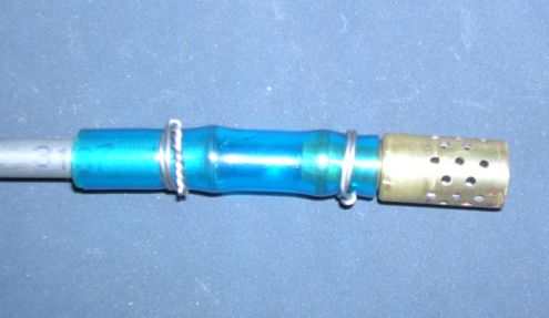

While the tubing may soften or expand, if you secure it with a safety wire clamp it won't fall off. These fit down the 1/2" hole in the plastic tank without any problems. They become an inspection item for annuals and will have to be replaced periodically, but unless they are allowed to rot they'll be where they're supposed to be.

Your photo looks a lot like the set up I had... (I like your pick-up better.)
It took a little over a year for my blue tubing to disintegrate into pieces of blue jello, leaving the pick-up rolling around the bottom of the tank.
Your point about regular inspection is well taken.

Richard, In this case it was a TNK improvement. When I bought new tanks I bought new pickups too. When I pulled the old yellow tank that came in the plane the pickup bushing flange was slit all the way to the center and there were stains inside the fuselage that could have been fuel seepage or it could have been spill. When the top mount pickups came from TNK, I just went with it.
