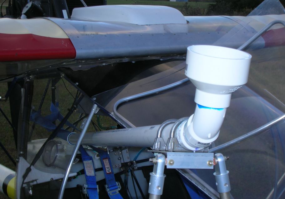

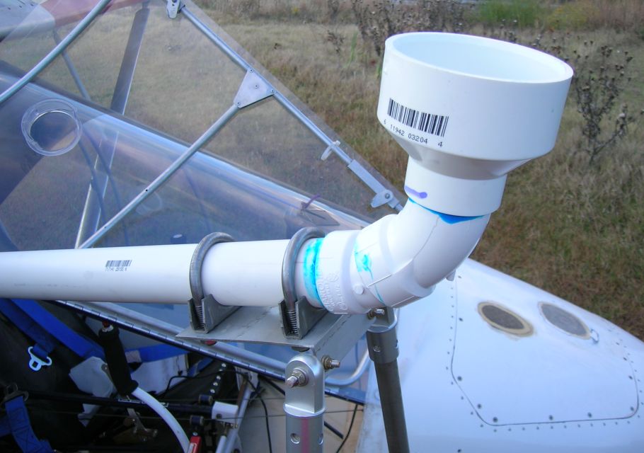

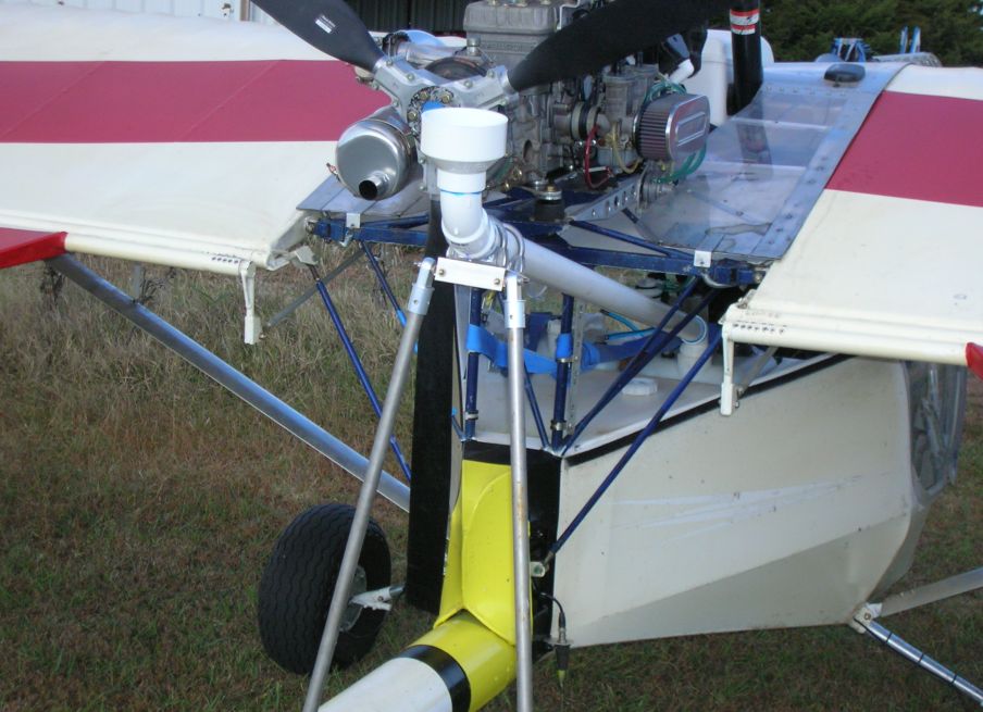

Awhile back Grant, I think it was, asked about methods of filling his Kolb Mk 2. I have tried everything I could think of short of buying a filling station pump, and I briefly considered that before I priced them. I did try several different brands of gas cans with no good results and I have one of the plunger pumps that is made for one brand of gas can. They work okay if you want to squat and pull a plunger handle up and down for 20 minutes per tank. As for me, I didn't enjoy that experience either. So there I was in the plumbing aisle of Big Box Chicom Sales when inspiration struck. A 4' piece of 1 1/2" Pvc, some elbows and street ells and a 4" to 1 1/2" reducer were all I had to buy, the rest came from various strategic supply (junk) drawers. I'm especially fond of the titanium tube legs, but even those came from the strategic reserves (junk pile) by way of Boeing Surplus.  Anyway, as you can see it works from front or back so when I enclose the pod for winter flying I won't have to remove a side panel to use it, just move it around to the front and take a little care not to splash on the lexan.
Rick Girard
Boeing Surplus.
Rick Girard
<Filler from front.jpg><Filler from rear.jpg><Filler from front
close up.jpg>
