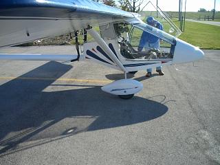

You can feel the air flow coming back up the fuselage tube like some one with a leaf blower at the aft end.If you moved the vent close to the fuselage the fumes will end up in the cabin.I had to make a 4" thick foam plug with slots cut for the cables placed just ahead of the elevator and rudder balcranks at the rear of the fuselage tube.Made it about an inch larger than the tube diameter.Just made a cut for the cables at the 10,12,2 and 6 o'clock positions.When I changed the exhaust system ,it let me know in a hurry.
G.Aman
