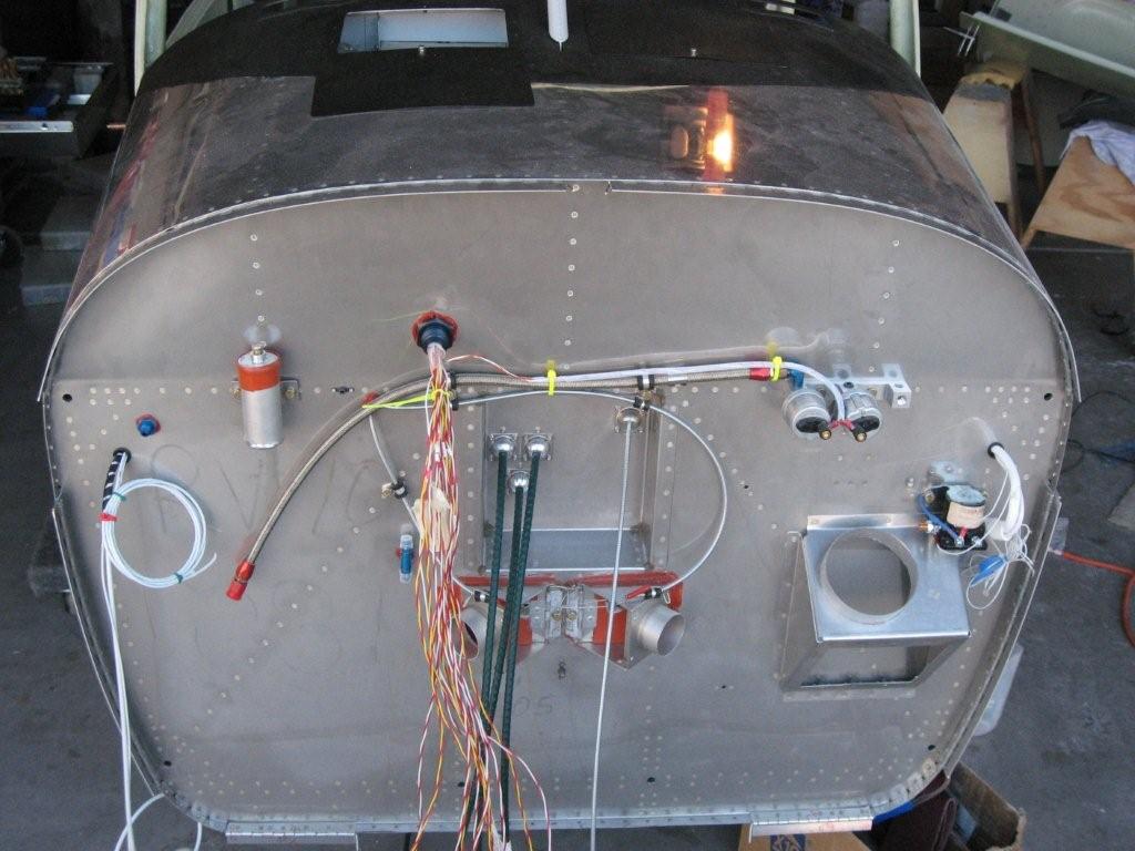

For the new builders, here is a firewall layout that worked. I used the
quadrant and the Van's cables for mixture and throttle would be more
suitably increased in length about an 1-2 inches. Prop cable was easily
sufficient length.

OK, I've gotta ask - is the hole in the glareshield for GPS? Or, the world's biggest defrost?

I never understood that either as after the windscreen is on there is no room to actually get your hands C arms or head in there to work on the avionics. Perhaps a removable windscreen is in development.

The glare shield holes (both sides) are for easy access to the backside of the panel. At my age standing on one's head for the time required to disconnected the EFIS connectors is unacceptable. I hold those panels in with cap screws so that the can be removed with an Allen wrench after the windscreen is installed as my panel is not removable (in sections) . From: owner-rv10-list-server(at)matronics.com [mailto:owner-rv10-list-server(at)matronics.com] On Behalf Of John Gonzalez
