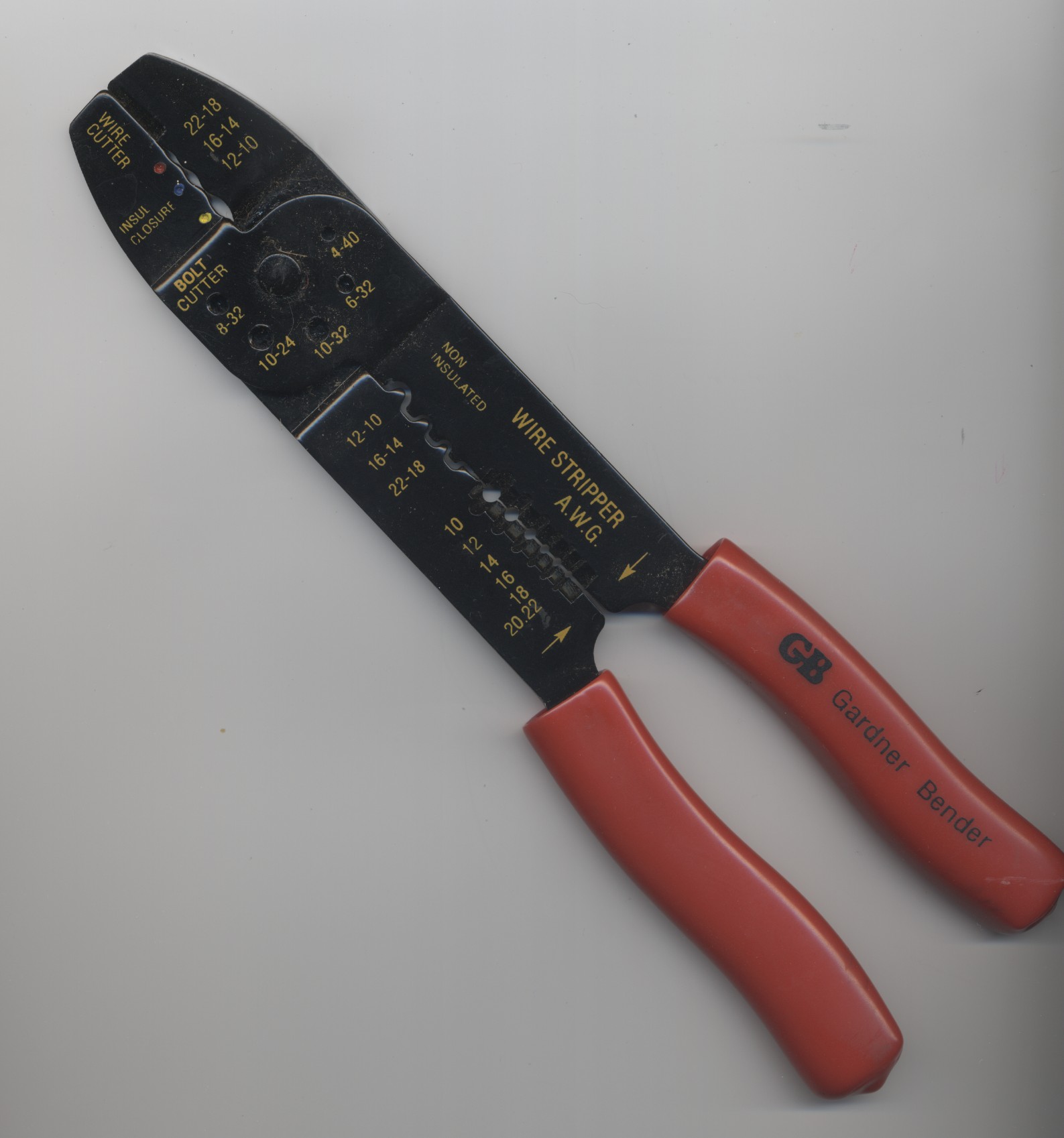

I would have used insulated terminals, but they don't make faston insulated terminals for 8AWG. I already have the wire, so need to go with what they make, uninsulated open barrel faston receptacles with separate ears for wire and insulation. I've seen the open barrel crimpers with butt-cheek pockets, but I don't have very many of these connections, so I'm thinking I could use my cheapo GB crimper. It only goes down to 10awg, but since it's not a cycling crimper, it might work. Or I could bend the tabs over individually using a pair of pliers.

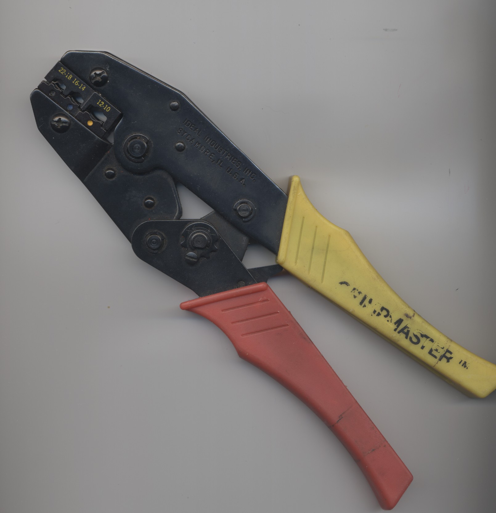

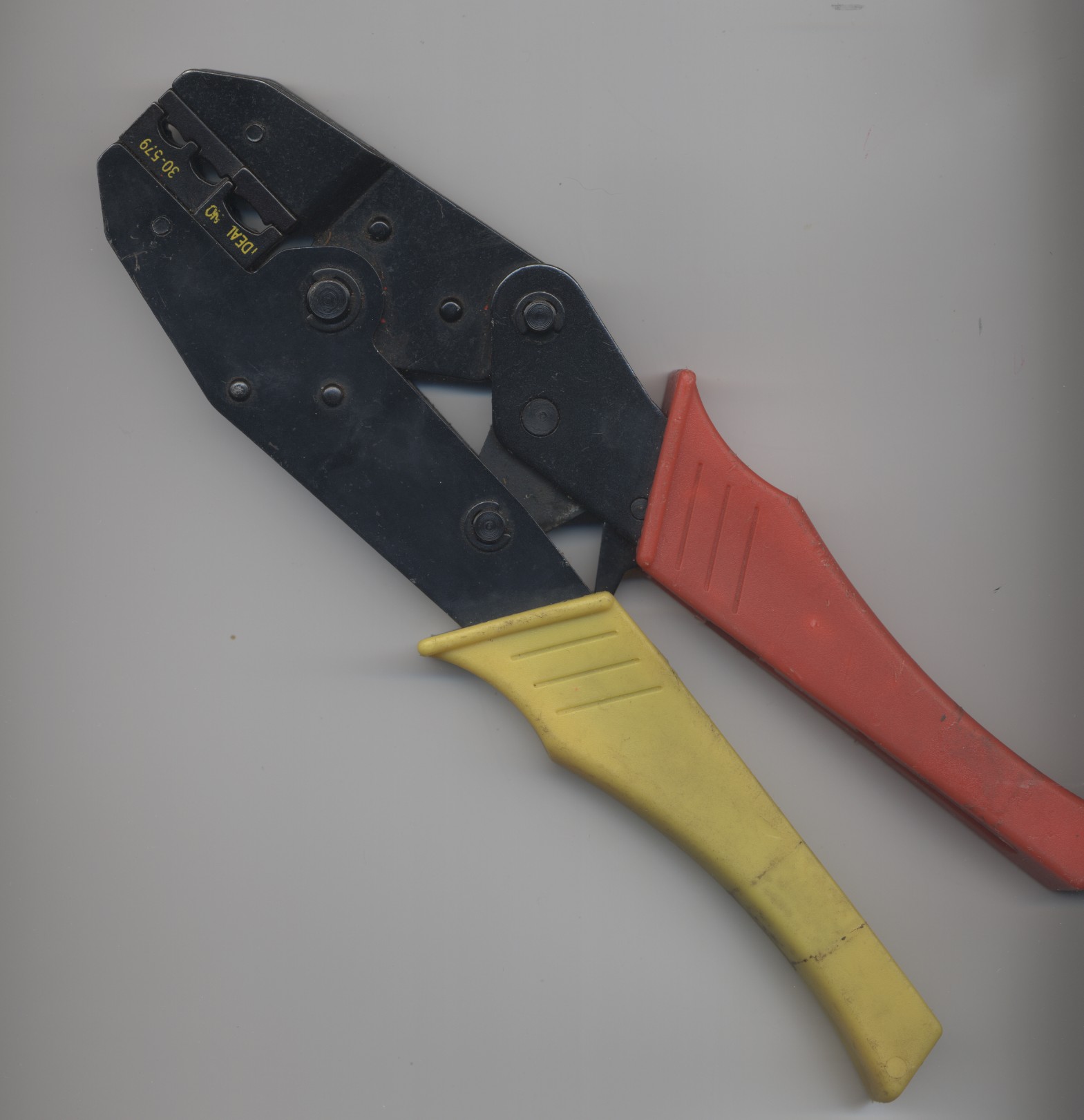

Another issue I have is figuring out which end goes where with the Crimpaster for PIDG terminals. The left side of the tool have dies shaped like flying saucers and are coded with numbers and colors for size. The right side ones are more elliptical. The right side also is a little narrower than the left. So the terminal sticks out the left side and the wire goes in from the right?
This is explained in the last panel of:
http://www.aeroelectric.com/articles/CrimpTools/crimptools.html
I saw this in that article:
As a general rule, tools with unsymetrical dies will have a smaller, closed-die cross section on the wire grip side.
which sounds like it would apply to the Crimpmaster.
Correct
