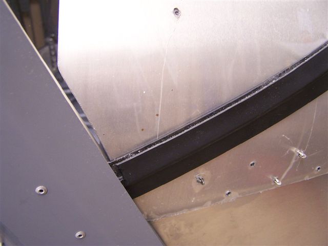

I don't feel at liberty to post a full picture of his beautiful plane, but the trim I am looking for is in the attachment.

I got similar stuff to that from Aircraft Spruce. Don't recall the part number though.

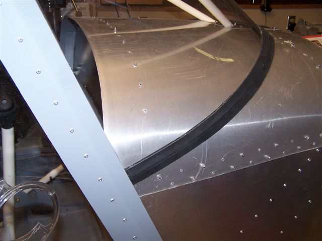

The part I used was ACS 05-01500 ($.97/ft). Pictures is attached.
http://www.aircraftspruce.com/catalog/appages/opencenter.php
I used Permatex #80328 Weatherstrip Cement to glue it in place. It did not
work. I'm looking for something better to glue it. Anyone know of
something that works?

s.clive.richards(at)homec
PostPosted: Fri Oct 23, 2009 11:09 am    Post subject: adhesive Reply with quote
Hi Ernest
Ray used Poly Zap on his 601as recomended on zenith list
some years ago
Clive

larry(at)macsmachine.com
PostPosted: Fri Oct 23, 2009 12:42 pm    Post subject: adhesive Reply with quote
Curt,
You might look up a product called Poly Zap. That's what I used for my
acrylic to trim rubber and it works well
for 4 years now. Only takes a drop each inch or so to the bottom of the
groove.

craig(at)craigandjean.com
PostPosted: Fri Oct 23, 2009 10:41 pm    Post subject: adhesive Reply with quote
Also as I recall you don't use a continuous bead. Instead use a drop every
inch or so.
