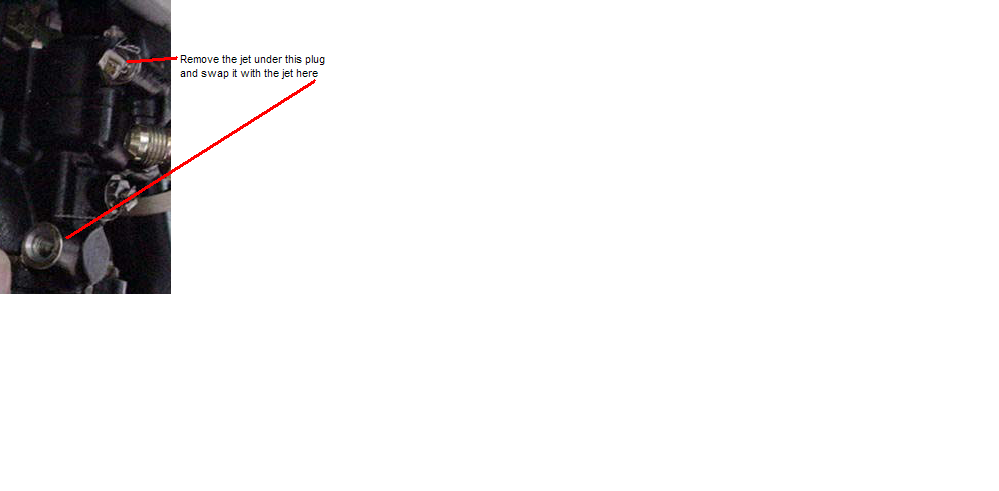

Although I have used this "fix" on several M14 carburetors, Termikas has found an even better solution. The problem has always been the accelerator pump jet diameter being too large, including even the smallest jet which is .9 mm. What Termikas has found out (and I have done this on my engine) is to remove the jet in the accelerator pump at the TOP of the chamber just above the one shown in .pdf file pictures. See attached. The jet at the top is always .6 mm and it seems that placing the larger jet at the top of the accelerator pump does not have any negative operational results. It does remove the hesitation and the accelerator pump remains in full operation.
Dennis

PostPosted: Tue Oct 20, 2009 3:06 am    Post subject: M14P Jet Mod Reply with quote
The difference between plugging and swapping the two jets is, by swapping the two jets the accelerator pump is not degraded or disabled. Personally, I think it is a better solution even though for 7 years I had been running mine with the lower jet (1.0 mm in mine) plugged.
