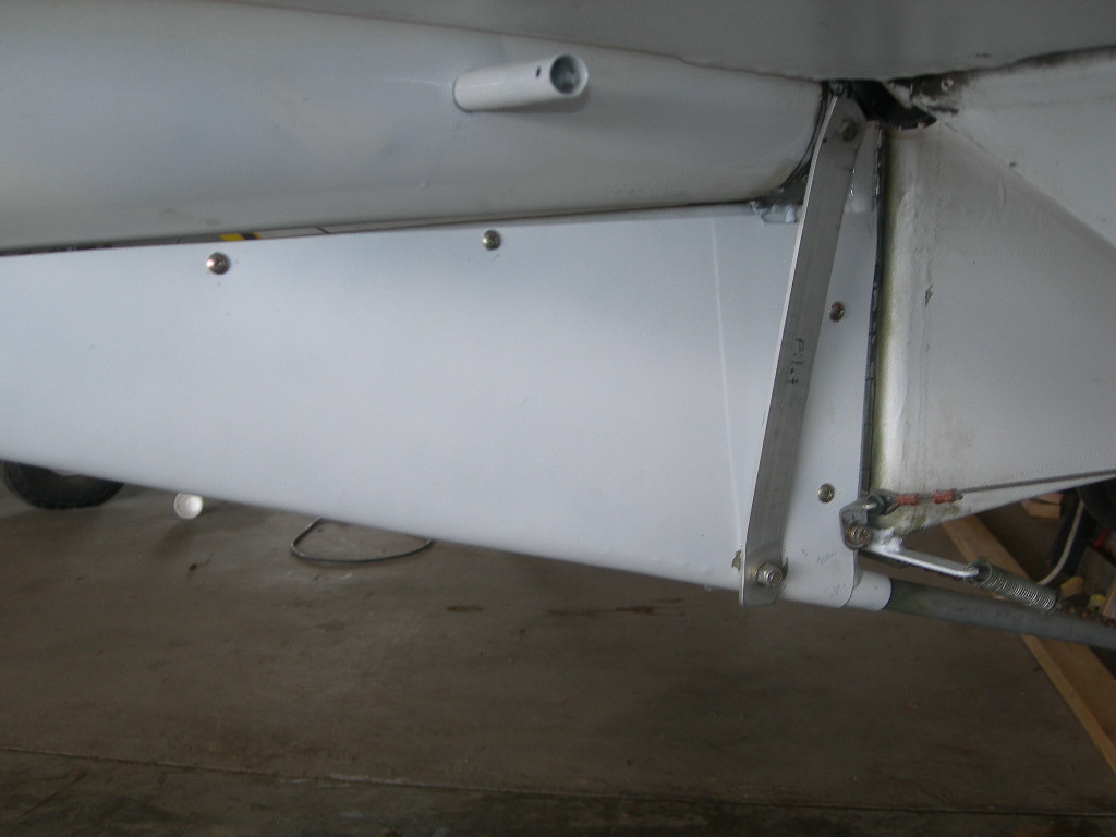

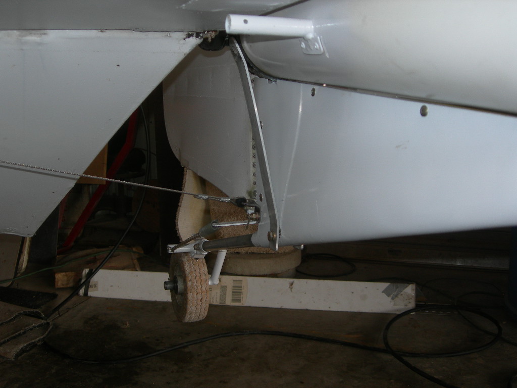

Here's what I ended up doing after cracking my tailpost assembly. I think adding the stiifener struts will help strengthen that area, thanks for the advice I received. I used some 1/8" x 1" Home Depot Aluminum bar stock and put an AN3 bolt through the tail ring, & used the existing tailwheel rod connector bolt location for the bottom.
