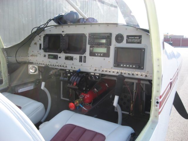

Another alternative is a fire bottle. With the fuel selector off and a fire
bottle discharge there is a high probability of putting out a fire.
