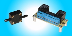

PostPosted: Wed Oct 14, 2009 3:25 am    Post subject: Control Stick/Flap Switches Reply with quote
You can put a flap switch on the control stick and install an airspeed relay like this
http://www.aircraftextras.com/RelaySpeedCont1.htm
which will give you accidental flap deployment protection.
I know that this is not the KIS way, but it is a way.
I’m not related to “aircraft extras”, just an happy customer (although didn’t test it in flight yet)
Interesting. I would caution folks about urges
to add "bells and whistles" to their projects
"just because we can". The FARS began speaking to
the style, location and operation of flap and
landing gear handles very early on. Years of
experience with mis-operation of the simplest
of control systems drove the heavy duty thinkers
to advise (if not demand) standards that go
directly to reduction of accident due to error
(human factors) and/or failure (equipment
lacking robustness), or failure tolerance
(UN-elegant design).
The product cited in the link above is an interesting
discussion point. Diaphragm switches for low delta-
pressure (IAS sensors) are not very robust. Hardly
a device I could get qualified onto a TC aircraft
for the goal of "increased safety" . . .

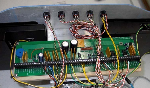

The relay board in the picture uses "mash-em"
terminal strips not unlike those used in other
products offered to the OBAM aviation community
[img]cid:.1[/img]
again . . . another technology that I would not even attempt
to qualify onto a TC aircraft. No gas tightness of electrical
connections, no support of wires adjacent to the stress-riser
at the connections.
like this
