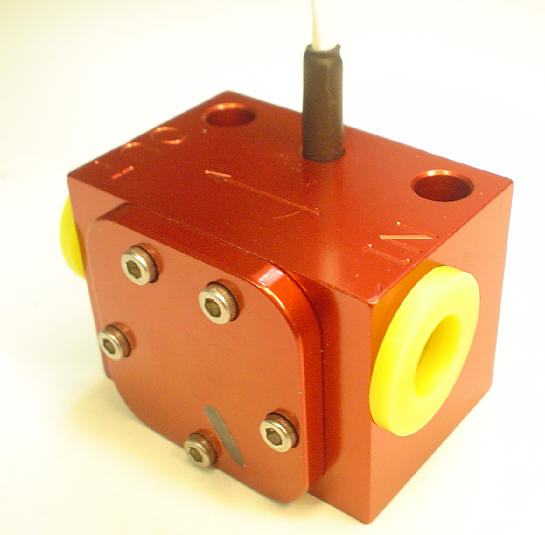

If you are going with AFS system, it is probably best to purchase the 6 CLY Sensor kit.  AFS packages the sensor kit separately.  In this kit are all the engine probes, sensors (including fuel flow) and wiring harness.  That way you can install and pre-wire all those items without having to shell out for the EFIS or EM until you need it.  Spruce has the 6 cylinder Sensor kit for $1,300.  All my sensors and probes are installed, my EFIS and EM wiring is done, but I still haven't purchased the EFIS or EM units yet.
http://www.aircraftspruce.com/catalog/avpages/af3400.php
As been mentioned previously, AFS uses the Electronics International "Red Cube" flow transducer.  I believe GRT still uses the original FloScan brand transducer.

Though physically different, electrically both the Electronics International (EI) "Red Cube" (used by EI and AFS) and FloScan (used by JPI, GRT, et al) are the same.
The FloScan part used to be the only game in town. Fuel flow sensors used to cost around $600.  EI developed their own electrically compatible "Red Cube" to offer with their line of engine instruments and the competition has brought the price of fuel flow sensors down to about $200.  Both units are fully TSO'd--not that it matter for experimentals.

I don't think UMA makes a flow transducer themselves.  If I was to guess, I would say that either EI or Flo Scan was the OEM for them.  Checking their site, they have the EI "Red Cube" transducer pictured.
http://www.umainstruments.com/FuelFlow.htm
The Flo Scan unit was the industry standard for decades and the electrical characteristics are well understood.  This is why EI chose to "clone" the characteristics--not to mention that they would not then have to change their instruments.
http://www.floscan.com/html/blue/aviation.php
Original Flow Scan
http://www.buy-ei.com/Pages/Miscellaneous/Misc_Flow.html
EI "Red Cube"

Thanks for the info and the photos. Now I realize the FT 60 is the red cube and the gray is the flo-scan. Actually I see now I have the flo-scan in my RV6 which came with my engine monitor, IK2000. I have it mounted in the engine compartment in a horizontal run before the mechanical fuel pump, where I was told would have the most accurate readings. It is not stable most of the time as I would expect it to be and my digital readout is always fluctuating, not sure if the FT60 would be any better? I believe that is the reason Matt Dralle sells the pulsation dampener? I don't have that but am tempted to try it.
I believe I will wait to see which monitoring system I end up with and use what has been tested with that system, thanks all.
