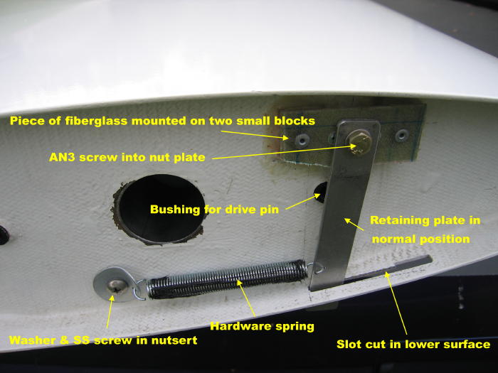

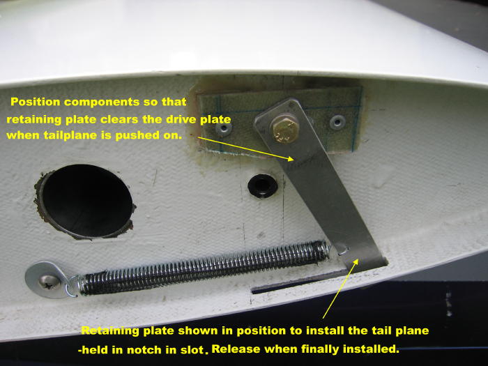

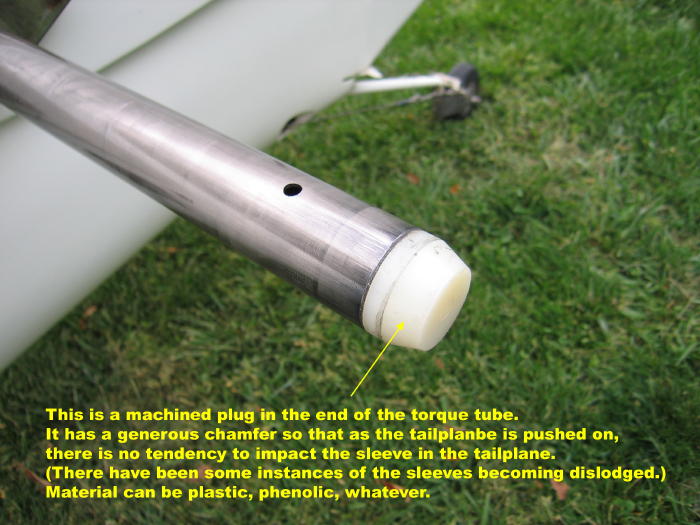

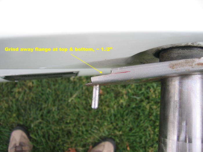

Regarding the tailplane retention issue, I attach some photos below of a modification which precludes any chance of the tailplane becoming detached. I think they are self explanatory. For those who get the digest and have these photos stripped off, let me know if you are interested and I can send them direct. This design is not mine and came from Europe - my compliments to the original designer, I do not have a record of his name. The end plug idea prevents enthusiastic helpers from damaging critical components.
Cheers, John
