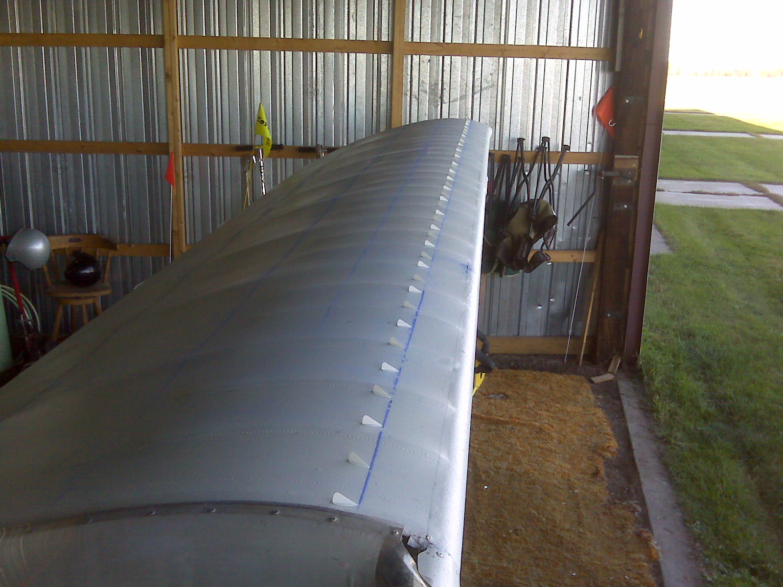

PostPosted: Mon Oct 12, 2009 6:28 am    Post subject: Re: tuft/stall testing (with video) Reply with quote
I used Stolspeed VG's. Kind of a cute little Mom/Pop operation out of Australia where the guy apparently got started using them on his Zenith in place of the big leading edge slat those planes have. He claims the vg's work better than the slat. The web page is very informative though and IMO has sound aerodynamic theory backing their installation.
http://www.stolspeed.com/
A generic set which includes 130 vg's, templates for installation, and some cool sheets of 3M adhesive that holds them tight but can be overcome with steady pressure so you can move them around is $97 (US). He doesn't charge for shipping.
The best evidence for an average plane is that they work about the same if placed within a certain range of the total cord of the wing (including flaperons), the best overall number being around 7% back from the leading edge. That's where I put mine and I haven't moved them. Stolspeed is very candid about how the experimentation he did within the recommended range didn't make much difference in overall performance.
The templates that come with are just simple rectangles of cardboard with slots cut out. The first 15 vg's beginning from the tip are spaced 30mm apart and are at a 30 deg angle to the slipstream. This is to ensure that the stall occurs at the wing tip last so as to preserve flow over any ailerons one might have (not applicable for us but still a good idea). Remaining are placed at the same angle but at 60 mm intervals all the way to the root.
I'll try and get a pic of the camera setup. Mean time, here's one of the wing showing the vg's more clearly than in the vid.

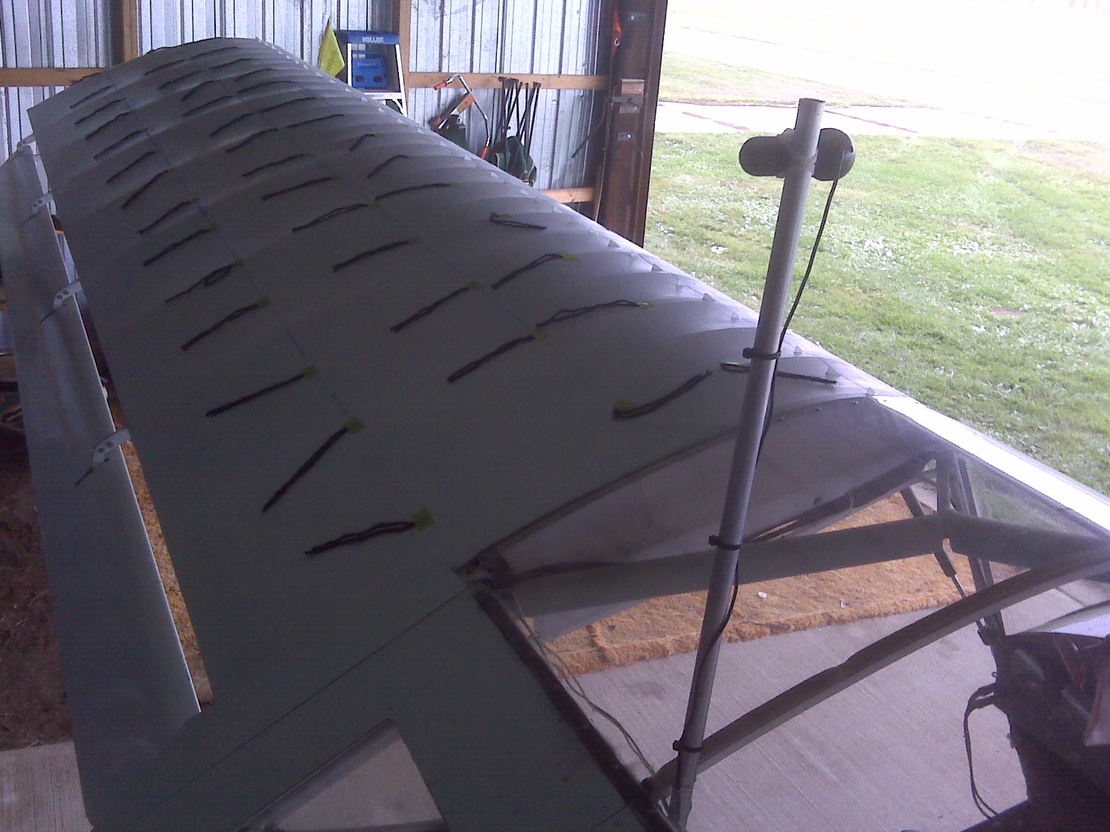

carlisle
Joined: 20 Jun 2009
Posts: 72
Location: Sioux Falls, SD
PostPosted: Mon Oct 12, 2009 2:25 pm    Post subject: Re: tuft/stall testing (with video) Reply with quote
Here's the camera setup. Just a cheap webcam shoved up through a hole drilled in the roof Lexan just where it meets the turtle deck. Gonna replace the Lexan this winter anyway. Everything held in place with nylon tie wraps. Laptop sits on passenger seat where I can fuss with it in flight. Plan to do some more vids with it facing foward and backwards!
Chris
