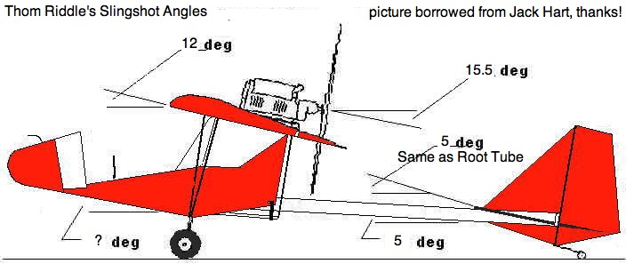

While I had my Warp Drive Protractor out measuring the new pitch of my TN prop yesterday, I decided to see what the incidence angles were on my Slingshot out of curiosity. I borrowed Jack Hart's drawing of his FireFly with incidence angles shown and edited the numbers to correspond to what I measured on my Slingshot. Image attached.
The Slingshot has a rather tall main gear so the root tube is angled up a lot more than the short leg Kolbs when on the ground.
In my mind, the numbers worth noting are the Horizontal Stabilizer angle is the same as the Root Tube. If at cruise speed the HS is even with the relative wind, then the wing bottoms are at about 7 degrees AOA and the engine centerline is pointing UP about 3 1/2 degrees from relative wind.
If my assumption is wrong about the HS being level at my normal cruise airspeed then this would be wrong. Since it is supposed to provide a small down force at the tail, it is probably pointing down a little bit during cruise flight. In any case, the difference in incidence between the wing and HS is 7 degrees which seems like a lot to me.
I'd like to hear from others about these angles on their Kolbs. Especially from the few other Slingshot flyers on the list, but others as well.

I was not surprised at the approx. 7 degrees AOA (wing vs relative wind) which varies with airspeed. The higher the airspeed the lower the AOA and vice versa.
What I was surprised at is the decalage, i.e., the difference in incidence angles between the wings and the horizontal stabilizer. Attached is Jack Hart's drawing of his FireFly which shows a decalage of only 2 degrees, 11 (wing) minus 9 (HS).
I was also surprised to see the major difference in thrust lines relative to wing incidence. Note that on Jack's FireFly, at least at the time of this drawing, shows his thrust centerline to pointing down relative to the wing bottom with a negative difference of about 5 1/2 degrees. My SS thrust line is pointing up relative to the wing bottom by a positive 3 1/2 degrees.
I know these airplanes are different in many ways but these incidence and thrust-line differences are pretty major, which is what prompted my query about other Kolber's incidence angles. I've not looked at the SS plans to see what they call for but suspect mine is pretty close to plans and it handles very well. But I'm curious if any other Kolbs have this sort of incidence and thrust-line relationship.

My slip indicator is a yaw string and it is centered with feet off the rudders at my normal cruise speed. The rudder trim tab is bent only very slightly to the left, giving a little right rudder to accomplish this.
The ailerons do not have trim tabs but the left aileron actuating rod is extended a lot further than the right one to give wings level flight with no apparent force on the stick. But the ailerons appear to be in alignment with the bottom of the wings with stick neutral.
I have electric elevator trim and it flies with the trim indicator near center at normal cruise. What I have not looked at is the angle of trim tab with respect to the elevator when in neutral indicator position. I'll check then next time I am at the airplane.
I'm not very concerned about the difference in incidence of the HS and wings but am very curious about the thrust line difference. When I go to the airport next time I'll fetch the plans and see what was called for.

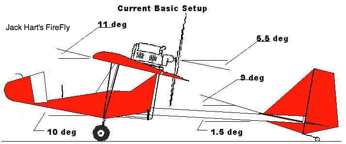

Been thinking about this a little more. I lowered my thrust line by
rotating the belt reduction unit on the Victor 1+. By doing so, I believe,
it moved the thrust line closer to the center of drag. This in turn reduced
stabilizer and wing loading for the same cruise speed.
See:
http://jackbhart.com/firefly/firefly101.html
We seem to have the same angle difference between the wing and the
horizontal stabilizer. But where I am trimmed for cruise at 50-55 mphi, and
max weight of 500 pounds, you are banging along at greater speed, weight and
thrust, with a higher thrust line and working the wing much harder than the
FireFly. I don't believe a FireFly comparison is valid. I believe your
best hope is to find another SlingShot owner.

I agree that the only things our airplanes have similar other than being Kolbs, is that the wings are similar in size so the comparison is probably not a good one. But yours is the only one I have data on to compare too, not to mention your drawing also being available for me to copy Smile.
On the ground my wing bottoms are at 12 degrees and horizontal stabilizer is at 5 degrees which is a difference of 7 degrees. That is a lot of decalage, compared to yours which is 2 degrees (11 minus 9). Yours is similar to most aircraft that I'm familiar with. As you know the more decalage there is the more longitudinal stability if all else is constant. The Slingshot is pretty short coupled, so that relatively short arm that the horizontal stabilizer is working with may require that much extra decalage. I'll know when I check the plans, if that is close to what was intended. I expect it is about right because the builder was something of a perfectionist, much to my benefit.
As you noted, your thrust line is much lower than mine and perhaps the major difference in thrust angle is also required for that high engine centerline, which I'll also measure on next trip to airport.
Thanks for your thoughts on this.

[quote] ThomInteresting discussion about AOL's of HS & wing. But I wonder if the boom tube of a Kolb in level flight is absolutely horizontal? Anyone have a good picture of a Kolb in flight with the horizon behind it?
Russ

Thom,
I have done quite a bit of research on the Kolb MkIII wing's incidence angles, (and have a data table of results), since I am having to change the incidence from the Classic angle to the Xtra angle (since my MkIII has undergone a rather complete transformation from starting out as a Classic to now being an Xtra).
Yes, believe it or not, 7 degrees incidence , in level flightseems to be pretty close to what my research has shown. 7 degrees incidence sounds like a lot, and frankly, I think it is, but it must be what Homer had intended. Evidently, a high incidence wing angle gives the performance that the Kolb are known for.
I do know of at least one individual who is considering lowering the incidence on his MkIIIC.
Mike Welch
it?
Russ,
I checked the FireFly out with a AOA meter. At cruise the tail boom tube
would be 4.5 degrees up.

If your tail boom is inclined 4.5 degrees up at the tail end during cruise that means your nose rotates down about 6 degrees from 3-point and gives a cruise wing AOA of 5 degrees, which is pretty close to cruise AOA of lots of airplanes, and the HS AOA of about 3 degrees positive. Useful and interesting information.
