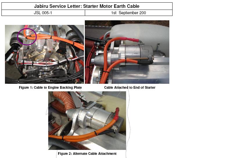

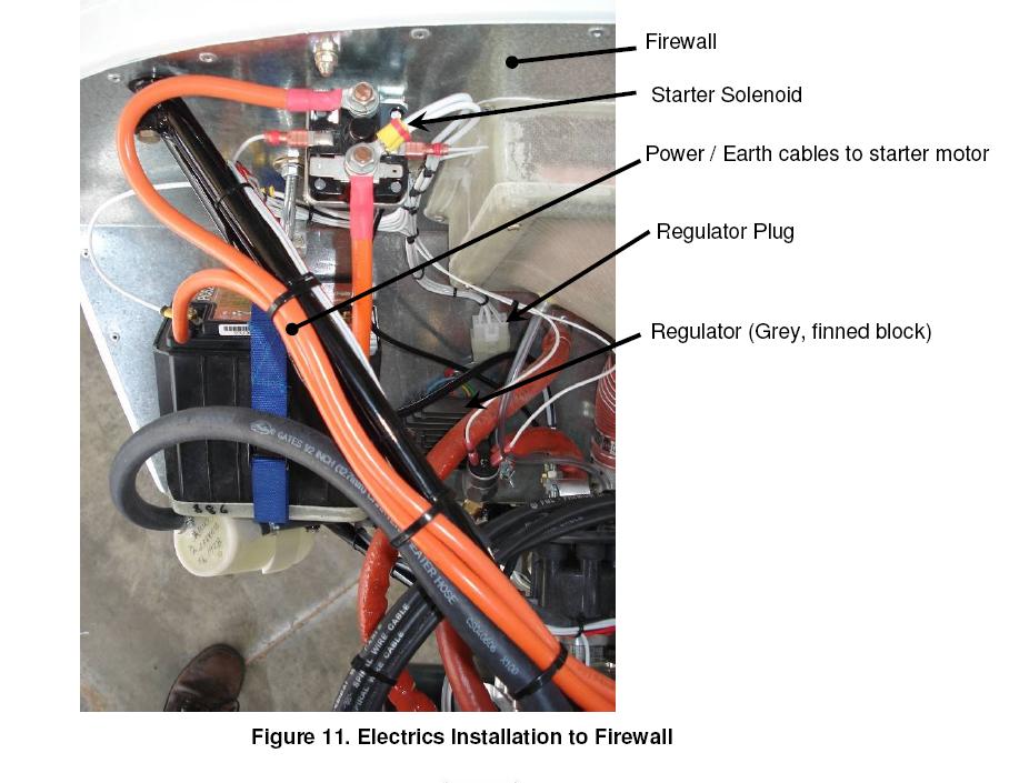

In the Z diagrams that I’ve seen, Bob shows wiring from the battery positive to the master contactor, then to the starter contactor. Some people wire directly from the battery positive terminal to the starter contactor instead, then to the master contactor. This seems like it would provide more juice to the starter and eliminate a short section of heavy cable. Is there a disadvantage to doing this?
And I understand it is best to ground everything to a common ground block on the firewall. Jabiru suggests grounding the starter case to the negative battery terminal. I would instead run this starter ground to the firewall ground block. Would this take the place of a separate engine block ground called out in the Z diagrams? If not, then where on a Jabiru 3300 would I connect for this ground? I would also have ground cable between the battery and firewall ground block.
Attached are pics from the Jabiru manual and service bulletin.

If the starter contactor or starter switch
sticks, there's no way to shut down a runaway
starter.

The z-figures are a product of many years refinement
tailored to the single-engine light aircraft but are
not "carved in stone". What you propose would work.
One suitable conductor between the crankcase and central
point ground is sufficient.

Doh! I knew it must have been something simple I'd overlooked.
Goodie!
