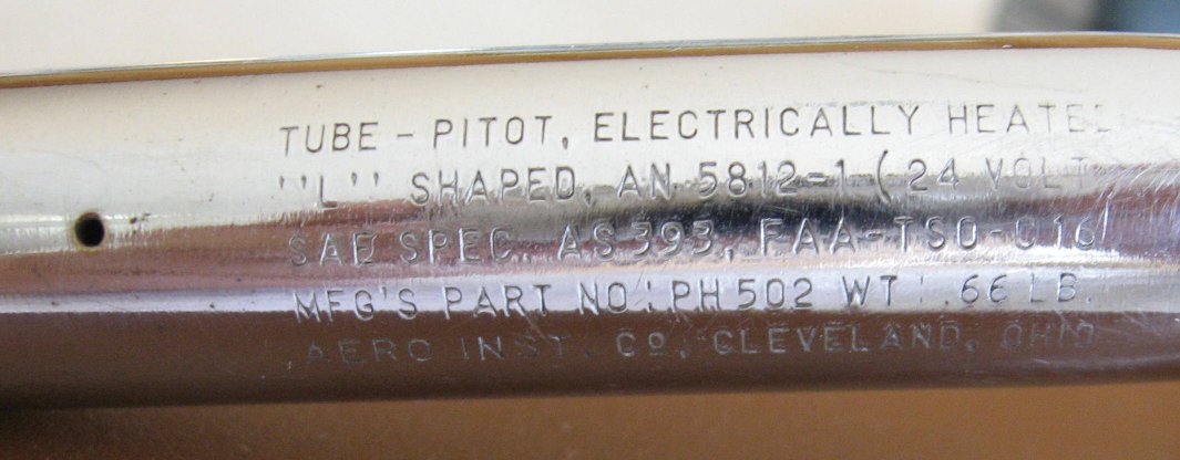

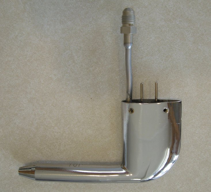

I have a chromed AN 5812-1 14V heated pitot tube from Aero Instrument
Co. and need the exact equivalent in a 12V model. Anyone care to trade?
Anticipating some responses that lead to thread drift: I don't want to
change the heating element. And yes, it gets hot on 12V but not hot
enough to suit me. I rather just swap with someone who has a 12V model
and a 24V airplane.

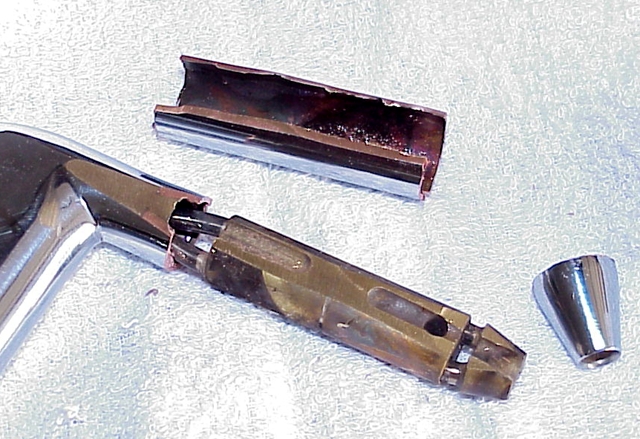

It's physically impossible to retrofit these devices. The
heating elements are stainless tubes about 12-15" long
with spiral wound segments tailored to deliver specific
amounts of heat to various portions of the tube assembly.
[img]cid:.0[/img]
Here you can see the heater tube as it loops twice through
the labyrinth chamber and around the nose piece. I had to
cut the tube apart just to SEE the heater . . . replacing
it as a maintenance operation is not an option.
And yes, it gets hot on 12V but not hot enough to suit me. I rather just swap with someone who has a 12V model and a 24V airplane.
What defines "hot enough to suit"? Know that the
crafting of a practical heated pitot tube involves
a careful study of ice accretion characteristics
under worst case conditions. The goal is to prevent
liquid ice (super-cooled water droplets) from becoming
solid ice on contact . . . this requires MUCH more energy
than that required to maintain the surface at above
freezing temperatures. As I alluded earlier, it's also
not a function of simply installing a heater . . . the
heater is a long, linear, un-even liberator of heat
crafted to the task.
