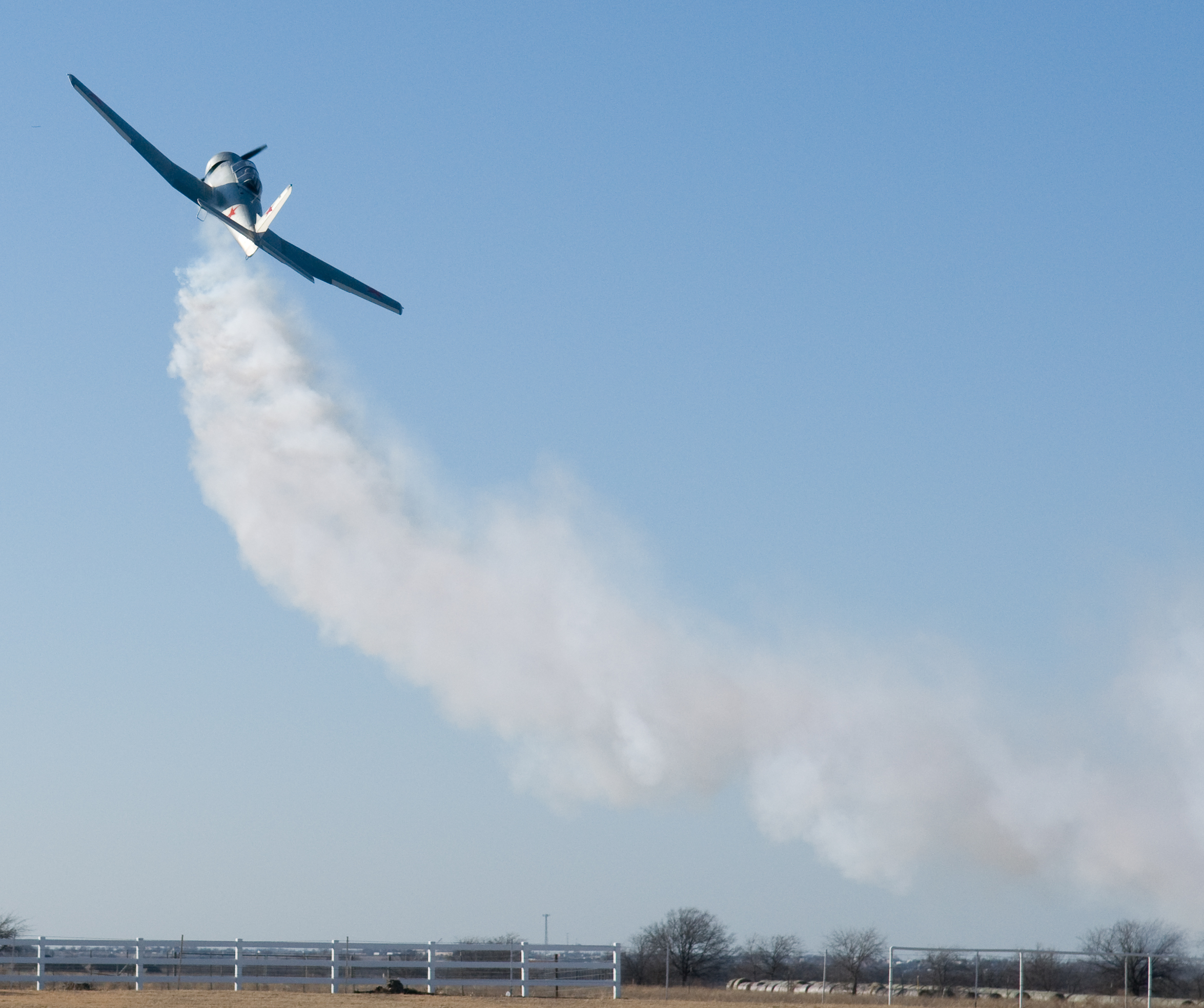

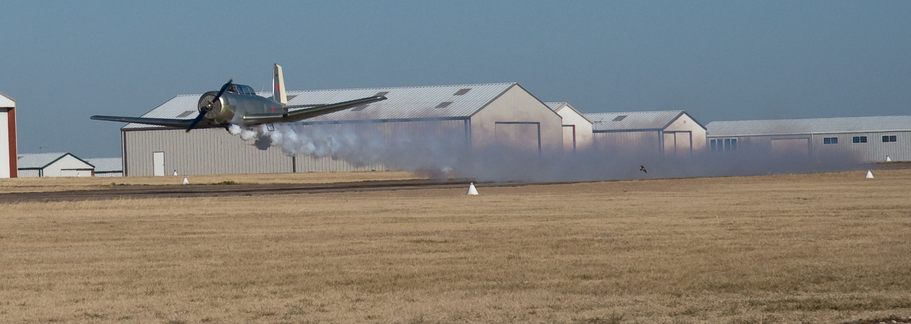

I installed a SA kit in January after a long debate about building my own system versus using some of his components versus using the entire SA kit.
SA talked me out of just using components when he:
1. Stated that the unit is not guaranteed if not a complete kit.
2. Offered me a discount that nearly negated the saving of using my own tank and some components.
3. I wanted smoke now and realized that there are lots of issues regarding pump size/output and nozzle size that I wasn't interested in resolving. I could have saved some money but I would have been a smoke test pilot and I was more interested in smoking out my neighbors.
It was an easy install. Telephone support was great as I had a question or two during the actual install.
Label me very happy with the performance of the SA kit. Twisted Evil

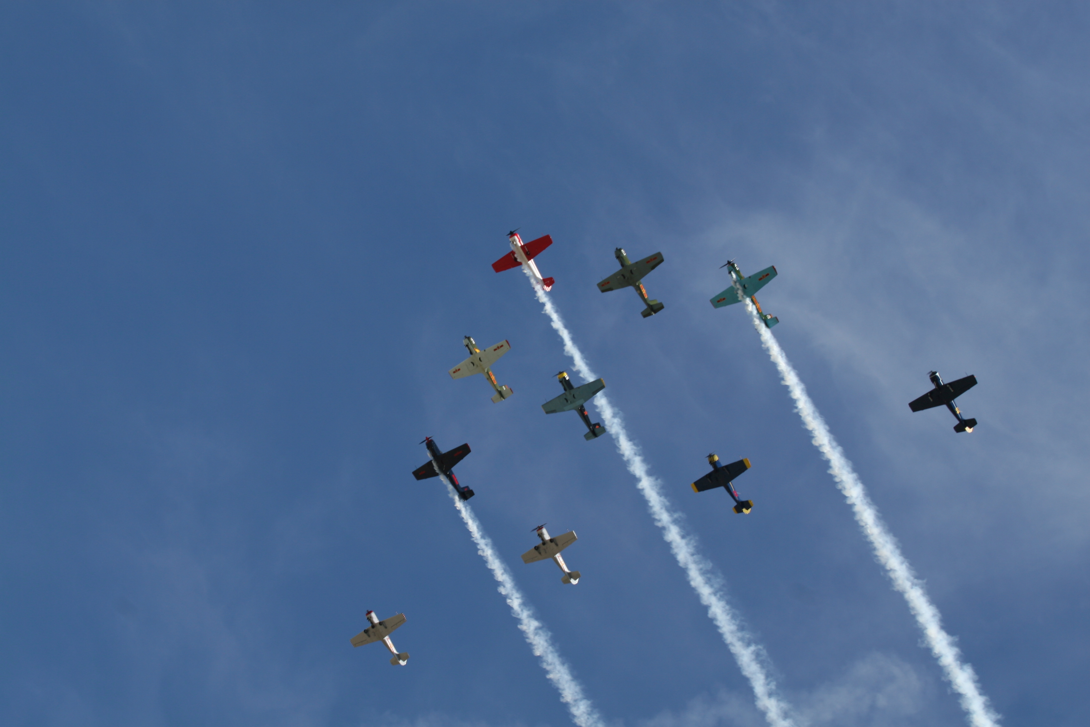

Guys...for comparison's sake.....
The lead aircraft is me in the -50 with a single injector. The smoker on the left is a custom system with 2 injectors (a tad more dense), the one on the right is custom single injector. Custom systems run about 2x the SA system...
