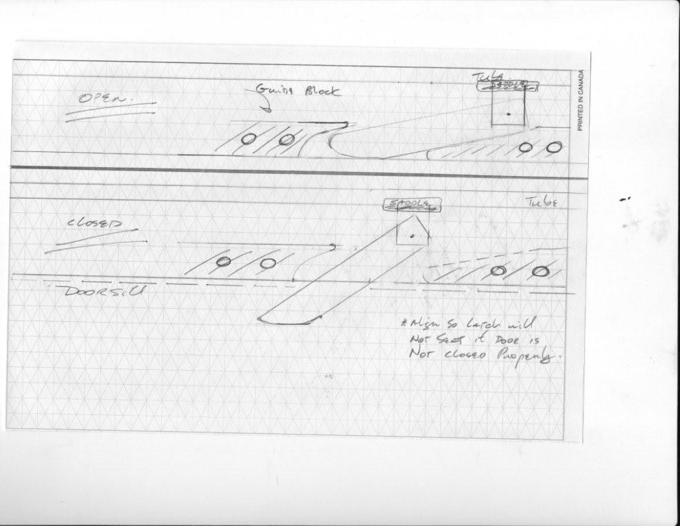

Hi
I am been fretting over the -10 door opening events ever since I first heard about them. I don't think an unlatched door should be catastrophic nor do I think we should rely solely on memory (doing a check) to be our first and last line of defence. I have on a couple of occasions, left my Cherokee door unlatched on takeoff. It was at worst a minor inconvenience and I have since mastered the art of latching it in flight (safely).
All that being said, I have been trolling the archives looking for various solutions. None seemed to fit my *must* requirements which are:
  • Any interlock should be operable from the outside of the aircraft. This is a huge safety issue - I don't want to be trapped in an a/c after an accident.
  • It should not operate if the doors are not aligned correctly for proper latching (this would prevent misaligned doors from being appearing to be closed when not)
  • It should not make door operation more difficult (i.e. stiffer / harder to latch / more steps)
  • It should be easily installed
  • It should be mechanically simple
A very nice to have requirement is that it should operate is that it should automagically operate when the door is closed.
Attached is a side view sketch of a design that came about after I saw how Steve Deniri integrated his billet handles into the -10 door. Basically it involves a 1/8" "knife blade" piece of AL (steel?) that drop into a notch in the door sill as the door is latched. There is a guide block embedded in the door that would cause the blade to swing down the door is latched or swing up as it is unlatched. For those who haven't seen Steve's system, he uses a saddle which is pop rivettted to the door tubes to cause a lever to be moved when the door tubes moved.
My thought is that the if the receiving slot in the door sill is just a little oversized as compared to the knife blade, the should be little or no more extra effort required to latch / unlatch the door.
I would also ensure that the blade could not be forced down into the receiving slot if the door was open too far for the door pins to engage the door locks. This just a matter of alignment and positioning.
The receiving block would be attached to the inside of the door using threaded screws. I would think that if the receiving block was made of sandwiched 1/4" thick AL, fabrication wouldn't be too difficult.
After noodling the sketch for a while, I think it would be best if this was installed in the aft 1/3 of the door, mirror image of what is shown. That way if the door was being pushed back, the knife blade would not be pulled out of the door sill notch.
Anyway, I am just a dumb ^*%^ accountant and not an engineer. I would appreciate any comments before I try to fab a prototype of the RV10 Mark 1 Door Interlock.
Cheers
Les

kearney
Joined: 20 Sep 2008
Posts: 563
PostPosted: Sat Oct 03, 2009 11:21 am    Post subject: RV10 Mark 1 Door Interlock Reply with quote
Hi
I am not sure if my post below didn’t come through due to the size of the attachment. I have shrunk the sketch so perhaps this will work now.
Cheers
Les

dlm46007(at)cox.net
PostPosted: Sat Oct 03, 2009 12:28 pm    Post subject: RV10 Mark 1 Door Interlock Reply with quote
This is similar to what Mike and I were discussing this morning. Except that the vertical piece would also be a beveled pin of the same material and the rear pin and vertical pin would be driven on a cam where the vertical pin would precede the rear pin slightly so that the vertical pin would pull in the rear portion of the door and the cam would also allow greater penetration of the rear vertical piece. failure of the vertical piece to insert would prevent closing the handle but closing it would ensure that both rear pins are inserted. People still do the same thing. Both inside and outside there is but one handle action to open/close the door. This said I will still close and check the doors.

kearney
Joined: 20 Sep 2008
Posts: 563
PostPosted: Sat Oct 03, 2009 3:04 pm    Post subject: RV10 Mark 1 Door Interlock Reply with quote
David
I thought about a cam but couldn’t see how to make it work because of the interference with the long tubes in the door. I am interested in seeing what you have in mind; I am always looking to borrow better ideas.
Cheers
Les

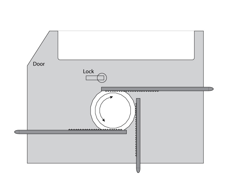

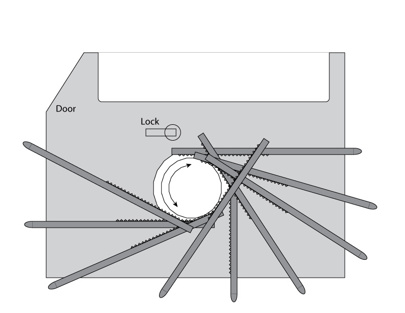

PostPosted: Sat Oct 03, 2009 3:36 pm    Post subject: Re: RV10 Mark 1 Door Interlock Reply with quote
Someone else has already suggested this, but I've thought about it and like it:
You can get 90% of the way to a better latch by simply removing the racks from the handle mechanism, and substituting longer ones (about an inch longer). They should be so long that the 'door open' position of the inside handle is now nearly full aft, or maybe even more. What this does is gives you much more pin engagement - over an inch, instead of 1/4", of solid pin thru the door frame. This may be enough to hold the door even if one pin "missed" and is outside the door.
Thoughts?
Bob Turner
RV-10 QB
dlm46007(at)cox.net
PostPosted: Sat Oct 03, 2009 3:57 pm    Post subject: RV10 Mark 1 Door Interlock Reply with quote
I haven't discussed with the engineer yet but first glance suggests that because the low placement of the rear pin that a twin gear/cam would be required near the aft end; this would require locating the door penetration pin higher in the rear door frame. I do agree that whatever solution that is to be implemented, it must remain a single motion lever (3 pin, fore,aft, down) to open the door whether inside or out. Also its apparent that any change will necessitate a large 4" by 4"? access panel attached to the door by screws for installation and adjustment From: owner-rv10-list-server(at)matronics.com [mailto:owner-rv10-list-server(at)matronics.com] On Behalf Of Les Kearney

I have always thought a round geared crank style door lock that would allow for extending pins an unlimited length into the door frame and fuselage completely eliminating the concerns related to the door pins barely engaging. Not that dissimilar to a bank vault which has locking pins extending in all directions. My concept would require a cranking motion to both engage and disengage the door pins. I have a multi geared version of this concept in my mind but it seems like most things in aviation are best left as simple as possible.
In this concept the rotating knob can be located in a number of different locations on the door. The handle can be as simple as an old VW window crank or as premium as a milled stainless steel disk with spring loaded self retracting crank handle. I do not know if this is an appropriate mechanism for door latching or if it has some negative implications in the event of an emergency extraction.
For those that are still concerned about three pins holding the door in place I have a deluxe model in mind. J
Robin

Along similar lines, how about a small bell crank attached to one of the rods to extend/retract a vertical pin? Just food for thought.
Todd Stovall
aka "Auburntsts" on EAA and VAF
RV-10 N728TT -- Flying
bhughes(at)qnsi.net
PostPosted: Sun Oct 04, 2009 5:53 am    Post subject: RV10 Mark 1 Door Interlock Reply with quote
A bell crank should provide an inward offset that would keep the
vertical pin throw short. The vertical pin would mate into an aluminum
guide like the ones some of us are using. The guide would be place
inward of the lower fiberglass door frame and bolted to the aluminum.
This should allow for easy retrofit and small alignment adjustments. A
small cover \ access plate would be needed to cover the bell crank gears
in the door shell and hide the vertical pin. Something like a large
rudder cable fairing would work for the plate.

Robin, I knew you were going to pipe in with something cool.
The Citation, being pressurized, has 12 pins that engage into the outer door structure. It has the bellcrank style with all of the pushrods coming from the center of the door. The pins are pointed at the ends and the holes in the outer structure are adjustable.
If you made the pins slanted they could pull the door tight against the seal.

Not too many comments on the practicality (and simplicity) of
this design. Does anyone see any glairing problems or issues with this
concept? It seems (to me) like a simpler package than the standard vans
unit or the aftermarket door handles.

Robin, I'll take two of the deluxe models!!!!!!!!!! My wife and I laughed our selves silly... thanks.

The thing I don’t like about a vertical down pin is that, due to its location in the window sill area, it will collect water when it rains and you open the door on the ramp. The water will go someplace and likely lead to long tern corrosion internally to the fuselage side (probably behind some upholstery.
I’ve been kicking around in my head a different approach that I hope to draw up soon and will offer it for comment to the group. Since I’m not building the doors yet I don’t even have the actual parts to measure to make drawings that will actually work but I’m close enough to make conceptual drawings at least.

I think I will still try to work on a vertical pin. It just seems the easiest with no other latches and still be easy for the passenger to close. I will still check it and have dummy lights.
I could machine a pocket for the vertical pin so water or anything else couldn't find its way into the aircraft. You could unscrew the pocket to empty it if it got foreign objects or water in it.
