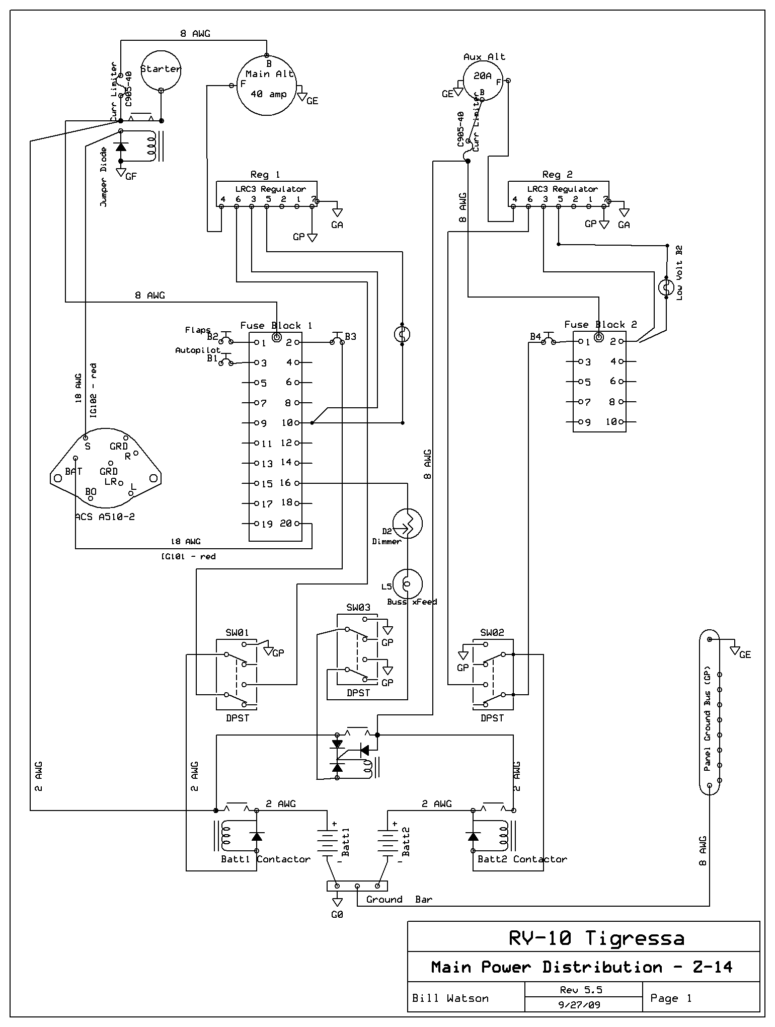

At 03:00 PM 10/1/2009, you wrote:
Some confusion here perhaps. I'm not using Visio - rather I'm using
the ExpressSCH product that Vern has linked to at his site. It does
have a bitmap export function which I just tried and attached the results.
Looks like that works ok.
You need fusible links upstream of your ov crowbar
breakers, NOT pluggable fuses in the fuse blocks.
You're missing a diode at the cross-feed contactor.
Where are your batteries mounted? 2AWG is too big
for forward mounted batteries. Suggest 4AWG.

Bob, thanks for giving this a review. I've responded below:
Robert L. Nuckolls, III wrote:
<nuckolls.bob(at)aeroelectric.com>
My thinking was the fuse is just protecting the wire to the pullable
breaker. The wire is 16AWG and the fuse a 15amp. Then the breaker is a
5amp. But I think what you are telling me is that the fuse could defeat
the whole purpose of having the pullable breaker. And that either a
fusible link is needed to protect the wire or a direct connection to the
buss. Is that correct?
Yes, drawing fixed.
It's an RV10 with both batteries in the rear. So I used 2AWG for the
run to the starter and for the interbattery connections. The other
battery has a (previously unmarked) 8AWG wire for the other run to the
front.
My analysis suggested that the 8AWG is enough for the 20amp Alt side of
the circuit even in a crossfeed situation.
Thanks again
Bill "finishing up the panel wiring" Watson
is a 5amp. But I think what you are telling me is that the fuse
could defeat the whole purpose of having the pullable breaker. And
that either a fusible link is needed to protect the wire or a direct
connection to the buss. Is that correct?
Fuses are so much faster than breakers that
you may pop a 15A fuse trying to open a 5A
breaker. There's a reason for the fusible
link depicted in the Z-figures.
the run to the starter and for the interbattery connections. The
other battery has a (previously unmarked) 8AWG wire for the other
run to the front.
of the circuit even in a crossfeed situation.
Do you intend to load the aux battery for cranking?
If batteries are in the rear, then contactors are
in the rear and crossfeed contactor is on firewall
to give you a fat-terminal, power distribution point
Use 4AWG welding cable off each battery terminal
to contactors and ground. 2AWG for run forward to
the starter contactor.
I must be back level on my printed out Z figs. The one I have has that
circuit connected directly to buss but in either case I get the point.
I'm going to add 2 fusible links (22AWG based) to the circuit and take
the power directly from the power feeds.
> the front.

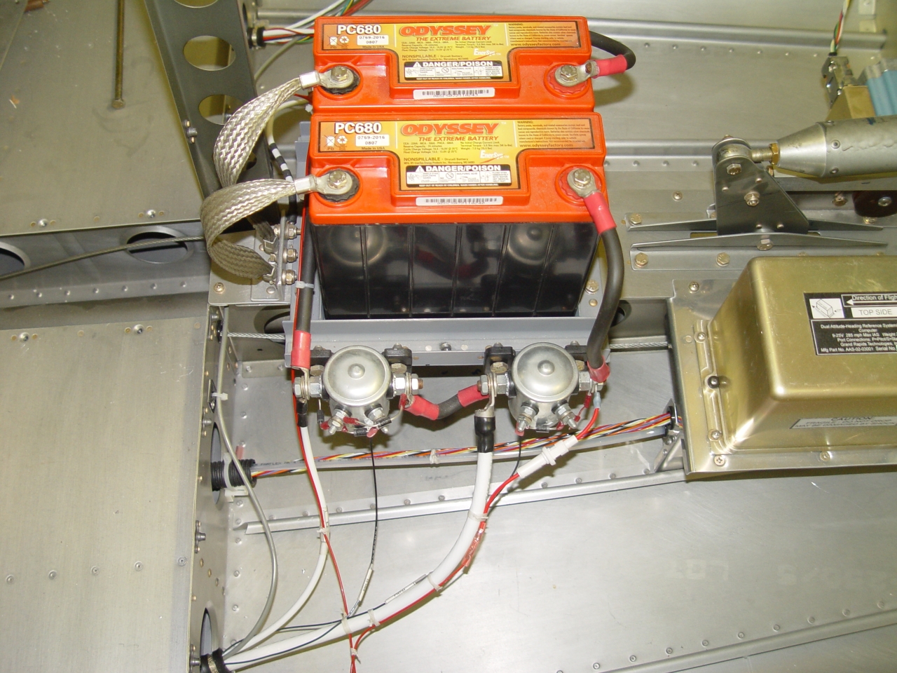

I did this a little different. I have all 3 contactors back with the
batteries. Then a 2AWG running forward for the starter circuit and fuse
board 1 with the majority of the load. Then a 8AWG line running forward
to the other fuse board. The batteries are twin PC680s (pic attached).
I can crank with both batteries or with 1. The plan is to generally
just use 1. All of this was done over a year ago so it's all installed
at this point.
- Why a Z14? In the end, I fell for the simple symmetry of the whole
thing over an E-bus solution. A bit irrational with some extra cost but
it's working for me so far. It is an all electric a/c with my dream IFR
panel (3 GRTs, G430w). No electronic ignition though.

PostPosted: Sun Oct 04, 2009 8:22 pm    Post subject: Re: Watons's RV-10 power distribution Reply with quote
Hi Bill,
Just curious: Why have you wired SW01 and SW02 to disconnect both the alternator and battery at the same time instead of using the progressive transfer scheme in most of the Z diagrams?
rck
MauleDriver(at)nc.rr.com
PostPosted: Mon Oct 05, 2009 5:20 am    Post subject: Watons's RV-10 power distribution Reply with quote
Ignorance perhaps. I remember considering the 'progressive transfer'
thing which I believe is specific and internal to the switch. Then I
went ahead and selected some lit rockers with the basic functions needed
(I thought). I may or may not have them documented correctly in the
diagram.
Do I have a problem here?
Bill

PostPosted: Mon Oct 05, 2009 5:23 am    Post subject: Watons's RV-10 power distribution Reply with quote
that circuit connected directly to buss but in either case I get the point.
Which figure are you referring to? I think I've
had a fusible link coming right off the feedpoint
of a fuse-block since day-one . . .
take the power directly from the power feeds.
Okay . . .

At 11:22 PM 10/4/2009, you wrote:
Hi Bill,

split-rocker, the Z-figures suggested that battery
and alternator be brought ON and OFF together with
a 2-3 switch. Even if you choose to use fuse blocks,
the crowbar ov protection system called for an
alternator field breaker which doubled as a means
by which the alternator could be disabled for battery
only, ground maintenance operations or disabled
in flight if the regulator or alternator became
unruly.
There's no foundation in physics for not bringing
the alternator and battery on and off together for
normal operating conditions.
> point.
Figure Z-14... I'm looking at the Adobe version since I un-installed
Turbocad awhile ago. The 5amp breaker is directly connected to Main
Power Distribution Bus and the Aux Bus
http://www.aeroelectric.com/PPS/Adobe_Architecture_Pdfs/Z14N1.pdf
PostPosted: Mon Oct 05, 2009 9:44 am    Post subject: Watons's RV-10 power distribution Reply with quote
Aha! That's an all CB airplane . . . so yes, the breaker goes
right to the bus along with ALL OTHER BREAKERS. If you use
a fuse block, then specialized feeder treatment for the
alternator field breaker is indicated.

OK, I just got lost. I looked at note 4 of appendix z and read the comments...
Z-13 shows fusible link and circuit breaker for alt fld between main power bus and master switch.
Z-14 has just circuit breaker for alt fld between main power bus and master switch.
Z-19 has just fusible link for alt fld between main power bus and master switch (circuit breaker is on other side of main power switch).
I don't understand the reason for the distinctions and how the fusible link helps a fuse in the fuse block. Especially z-14 vs. z-13 and z-19.
Tom Hanaway
Also working on an rv-10
RV-10. Built and sold
RV-8a. Building
PostPosted: Mon Oct 05, 2009 11:51 am    Post subject: Watons's RV-10 power distribution Reply with quote
I know you want Bob's response but let me see if I can share my new
found knowledge regarding the Z13 vs. the Z14.
The Z13 "Main Distribution Bus" is a fuse panel, that is, only fuses are
used for circuit protection. Because you need a breaker for the Crowbar
OV Protect module, a fusible link is used to protect the wire that runs
to the breaker. You don't want to connect the breaker to a fuse because
the fuse will blow before the breaker breaks. The fusible link will
blow slowly and allow the breaker to function as it must for the Crowbar
module to work.
The Z14 "Main Distribution Bus" is a regular bus bar with breakers
attached. In that case there is no wire running to a breaker to
protect. The breaker required for the OV Protection in the LR3
controller is simply attached directly to the bus bar which is the "Main
Distribution Bus".
Makes sense to me now!
Bill
comments...
Z-13 shows fusible link _and _circuit breaker for alt fld between main
Z-14 has _just_ circuit breaker for alt fld between main power bus and
master switch.
Z-19 has _just_ fusible link for alt fld between main power bus and
Tom Hanaway
PostPosted: Mon Oct 05, 2009 2:49 pm    Post subject: Watons's RV-10 power distribution Reply with quote
Yes, Z-13 is a fuse-block bus, it COULD be a Circuit Breaker
bus in which case it would look more like Z-14
. . . which IS a circuit breaker bus system.
Z-19 is also a fuse block system which means that it's
impractical to use one of the block-mounted fuses to
protect the extended feed-line to a crowbar tripped field
breaker. Hence the fusible link upstream of the 5A breaker.
It doesn't matter WHERE the breaker is along that pathway.
Bottom line is that no link is needed when the field supply
breaker ties directly to the bus with other breakers. When
fuse blocks are used, the EXTENSION of the bus to a remotely
mounted breaker gets ROBUST protection in the form of a fusible
link.
